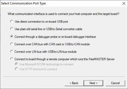

I bought  a  MKV10Z16 for FOC control a robot in-wheel motor.
I have ST-LINK, so I tried to connect MKV10 and freemaster with that but failed.
I can't even connect or check whether its running,
any tutorial or example for starting freemaster?
Thanks.

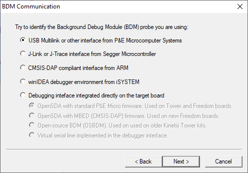

I didn't find the ST-LINK in the list of debugger probe of FreeMASTER Connection Wizard.
I don’t know if ST-Link has a USB to UART function, if so, you can try to choose this connection method.

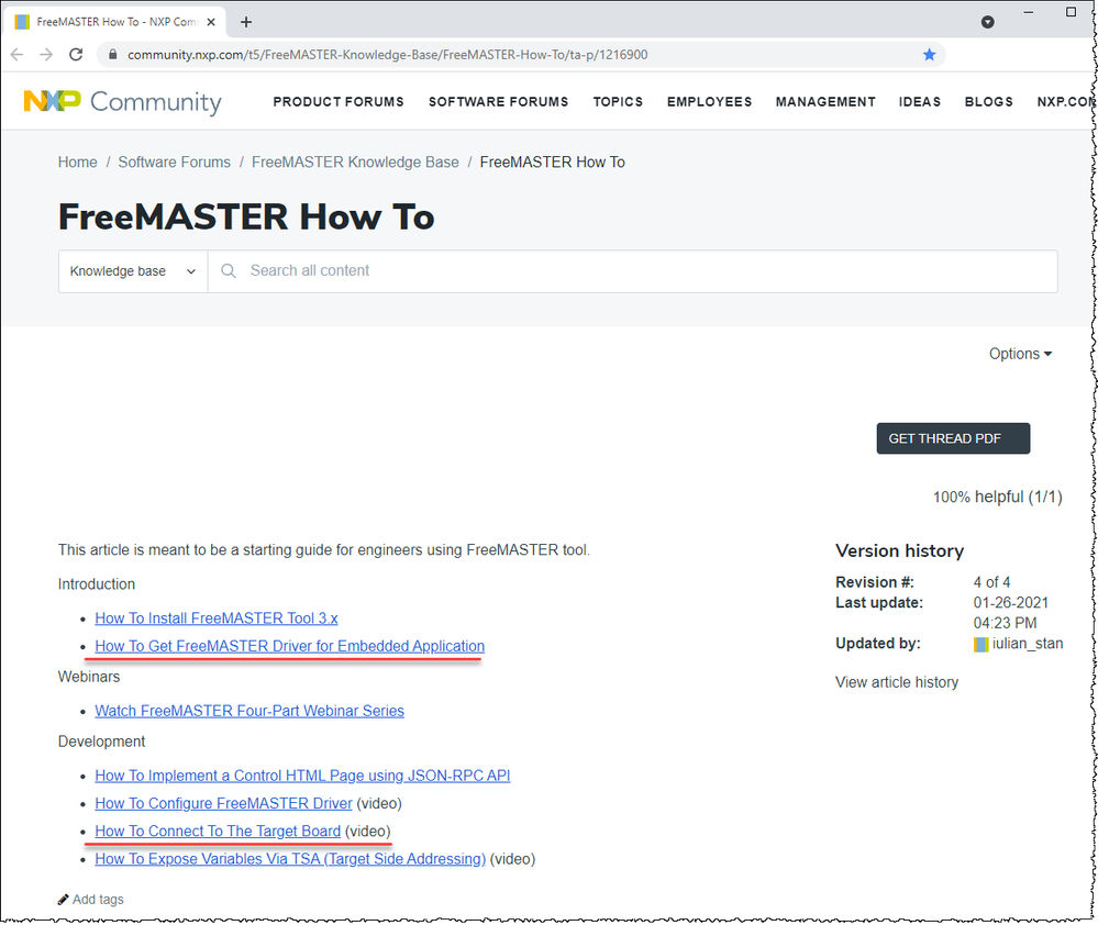

We have a FreeMASTER community forum, I suggest you go there to ask questions and get more accurate answers.
You can find tutorial or example there:
  • Check out FreeMASTER How To article

I am looking at, but it seems support only developer boards like frdm
how could I just start with standalone chip?
thanks
