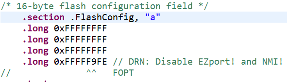

I would have a look at the RESET and NMI lines (is NMI disabled?).
The Reset line should have a pull-up (say 10k) with a capacitor (say 1uF).
I hope this helps,
Erich
2,493 Views
davenadler
Senior Contributor II
I disabled NMI in FOPT as well, same behavior (hope I did this right):
Not sure I understand about the RESET line - I'm using the K64F Freedom board; shouldn't this be already set up?
Thanks Erich, Best Regards, Dave
