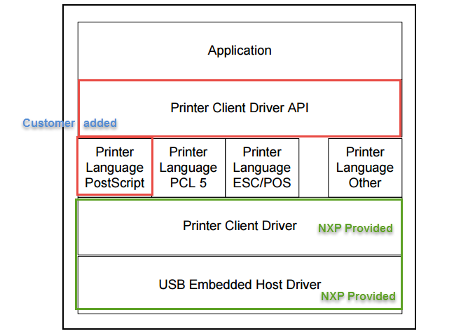

Hui_Ma
The KSDK V2.0 KL26 USB Printer device demo will be enumerated as Generic/Text Only printer. When customer want to print a PDF file, the PDF file must be parsed as a text file, otherwise there without any data transfer from PC USB host to KL26 USB device.
So, customer need to make up a PC USB device driver support those file parsing feature.
We will rise a requirement to KSDK software team about your mentioned USB device printer application.
While, I can not answer when this support other printer language such as postscript demo could be available so far.
Thank you for the attention.

Hui_Ma
The KSDK V2.0 software KL26 USB device printer demo  demonstrates the the plain text file printed, which doesn't need the printer language parser. The PC will transfer the ASCII data to KL26 via USB port, and after the data received, the data was sent to serial terminal.
For customer want to print the PDF format file, customer need to implement the [postscript] page description language supported.
PostScript – Created by Adobe Systems, PostScript is an interpreted, stack-based language with similarities to Forth and Lisp. Elegant, complex graphics can be described easily.
As below picture shows, customer need to add Printer Language PostScript driver and Printer Client Driver API to the USB Printer application demo.
Wish it helps.
