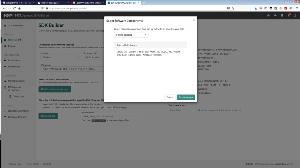

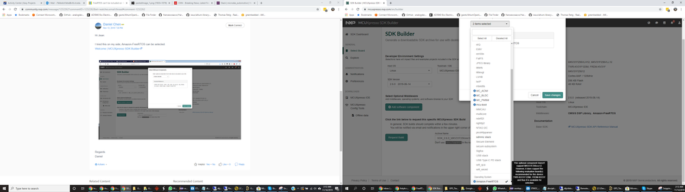

danielchen
Hi Jean:
I tried this on my side, Amazon-FreeRTOS can be selected.
Welcome | MCUXpresso SDK Builder
