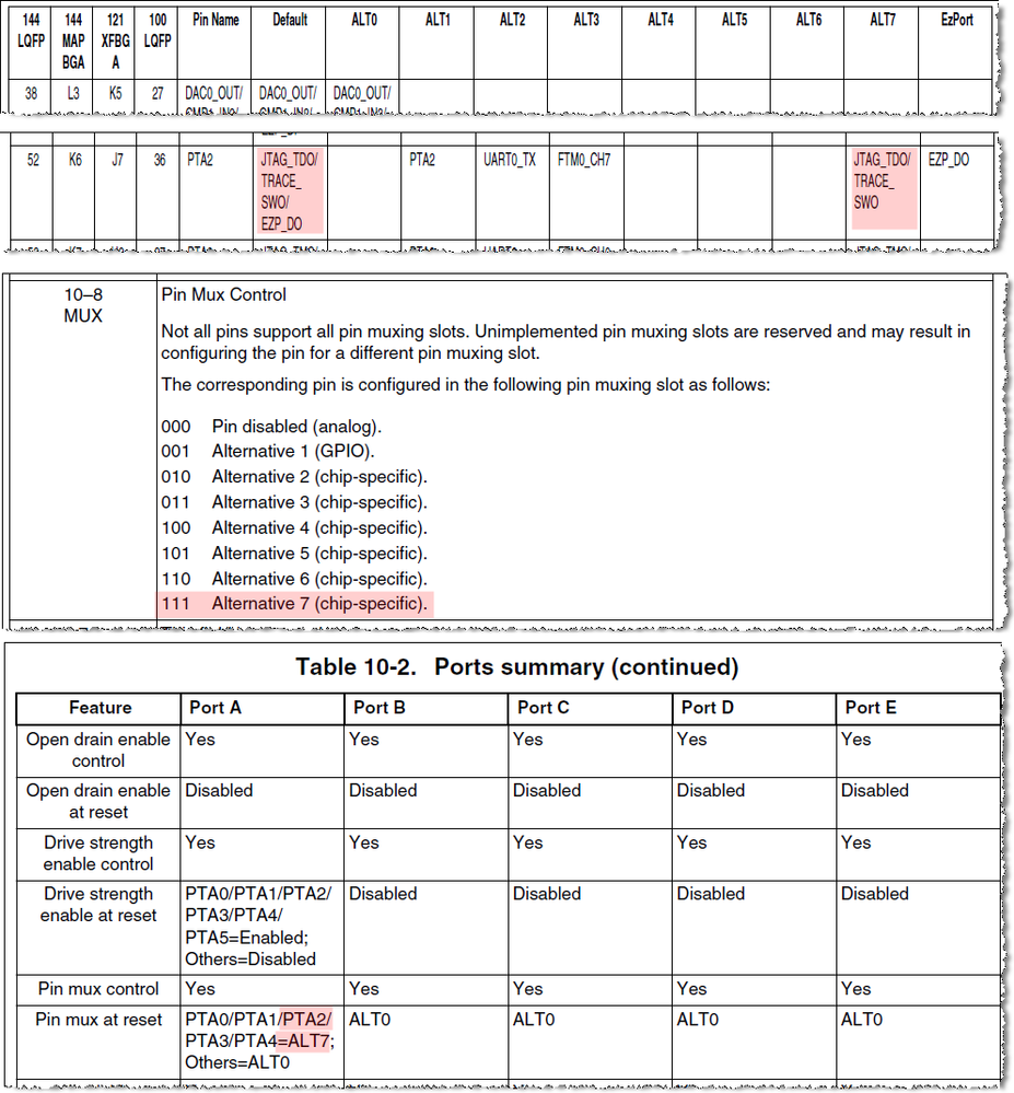

Hello... I need to toggle some of the FRDM-K64F GPIO pins. One of those pins is in the PTA port, the PTA2 pin, but I can't set it to  logic '1', it's always at 0V and I need to set it to it's logic '1' state of 3.3V. I have tried a baremetal code, I can set other pins except this one. The pins is shared with the JTAG_TDO and I think that's the reason. Can I get this pin to work as GPIO??
Here's my initialization code:
SIM_SCGC5 |= SIM_SCGC5_PORTA_MASK;         //Enable clock
PORTA_PCR2 |= PORT_PCR_MUX(1) | PORT_PCR_DSE_MASK;   //Chose alt1 as gpio pin and enable drive strenght
GPIOA_PDDR |= (1<<2);   //Set the pin as output
GPIOA_PSOR |= (1<<2);   //To set the pin at logic '1' but doesn't work :smileysad:

Change the line
to
PORTA_PCR2 = PORT_PCR_MUX(1) | PORT_PCR_DSE_MASK;   //Chose alt1 as gpio pin and enable drive strenght
and it will work.

Hi Alejandro,
Mark is right.
The PORTA_PCR2[MUX]=0x07 as default. So you need PORTA_PCR2 = PORT_PCR_MUX(1) instead of PORTA_PCR2 |= PORT_PCR_MUX(1).

alejandrovelez
Thanks Robin, you're right!!
