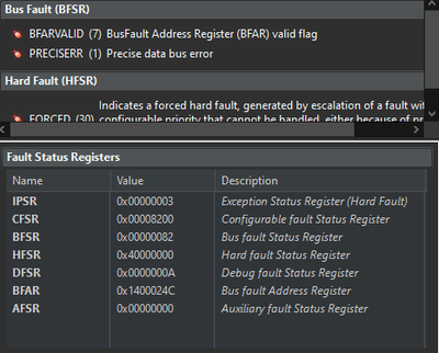

Hi, I am using the MK10DX256VLQ10 processor.  I have configured my FlexRAM to be 4K of EEPROM.
I am having issues getting periodic Bus Faults when reading from my EEPROM,  I am verifying that EEEREADY is set before I start reading.  The error typically occurs after everything has been running for a while.  It appears to be a timing issue, but I am not sure how to prevent it.  If I attempt to read an EEPROM value too quickly after a write function was completed I seem to get the bus fault.
After reading the reference material I was not able to find a flag that states the EEPROM is available for reading.
