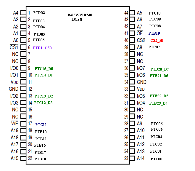

my teste Flexbus + SRAM  (  IS62WV10248DALL ) 1MBx8
CPU = K22FX512 , Clock = 120, core,bus,flexbus =60
Problems:  0x0000 0000 to 0x0000 7FFF                   ( READ AND WRITE ) = OK
> 0x0000 7FFF , not ( read and write )  ,   return to 0x00000000 page0.
Connection hw:

Hi Carlos,
can you share your whole Flexbus configuration?
Carlos

Hi Carlos,
The complete configuration is the same, alas this whole code.
I can read and write (0x0000 to 0x7FFF),
higher addresses can not be reached, eventually returning to BASE_SRAM.
one thing I noticed,arises proper value in  FB_CSMR_BAM (0x000F (1MB)  ) = ERROR FLEXBUSS. not init cpu.
thanks,
Carlos.
1,883 Views
Carlos_Musich
Hi Carlos,
You must use FB_CSMR0 = FB_CSMR_BAM(0xF);
Please check if the register value is set correctly. Otherwise check hardware connection, most likely this is the problem.
