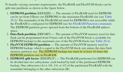

What I don't understand is how often the data will be transferred from FlexRAM to the E-flash. For example, if I define 64 bytes as EEEPROM (without splits), does that mean that the EEE state machine will only transfer the FlexRAM to E-flash UNTIL I write 64 bytes to it?
If that's true, then if I have written just 20 bytes to the EEEPROM (FlashRAM) and I lose power then I will lose those 20 bytes which is not right.
Is this right (I kinda feel it isn't but I'm not sure)

    In fact, to the customer, just need to partition the FlexNVM, to define the related EEPROM size, the backup size, please note, the EEPROM backup size must be at least 16 times the EEPROM partition size in the flexRAM.
Then, the customer just need to operate the flexRAM address as the eeprom address is OK.

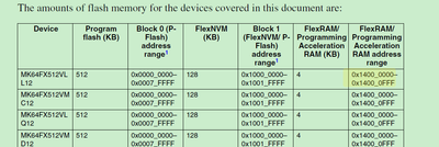

I don't know which kinetis chip you are using, give you an example:
#define LONGWORD_COUNTER_ADDR 0x14000040
#define WORD_COUNTER_ADDR 0x14000044
#define BYTE_COUNTER_ADDR 0x14000046

When you want to use the 64byte eeprom, you just need to operate the flexRAM, you don't need to care about the related flexNVM flash after you already partition it, the chip hardware will do it automatically.
As you know, EEPROM can be byte operation, so if you just write 20bytes, it will contains 20 bytes, not which you needed whole 64 bytes.
