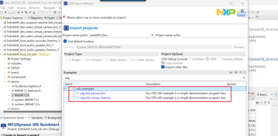

Hello @randyseedle ,
Thanks for your post. Please download our SDK from Select Board | MCUXpresso SDK Builder.
We have lots of USB demos here:
After downloading the SDK, you can refer to Getting Started with MCUXpresso SDK   for the next steps.

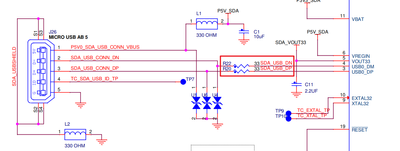

I finally found the OTG project, downloaded, and build it. It was missing a file:
system_MK64F12.h
I rebuilt with what was already on my system. Any ideas on testing this criter ? I saw mention
about a special pin ? Both my FRDM-F64F boards have USB type 2 micro B connectors. The
boards have 2016 on the back. As if that is when they were built. Is there a way to make that
work ? Do I need a special cable ?
According to the section 46.2.2 of RM, DM and DP I/O pads must connect through series resistors (approximately 33 Ω each) to the USB connector on the application printed circuit board (PCB). Additionally, signal quality optimizes when these 33 Ω resistors are mounted closer to the processor than to the USB board-level connector.
I have checked the schematic of FRDM-K64F-SCH-E4, it already soldered them:
So there is no need to solder with 33ohm resisters and no need a special cable
Hope it can help you.

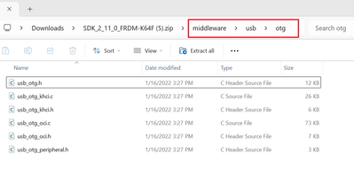

Sorry, The FRDM-K64F SDK don't have the On the go(OTG) demo, only have the OTG stack:
Please download the SDK_2_7_0_TWR-K64F120M, it has otg demos:
And you can also refer to Solved: Kinetis K40 USB OTG - NXP Community and take a look at AN3324 for OTG implementation.
