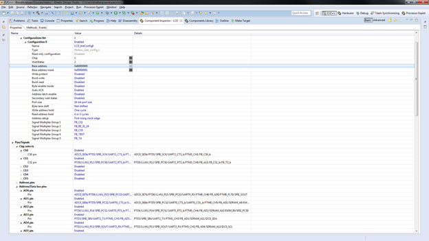

I am hooking up an LCD to a K65 uC and using KDS with PE setup to interface with the FlexBus.  Every time I try to access the address of the port to send data to the LCD controller i get a bus error.  What could be wrong?

Looking at the assembly code for the line *((uint16_t *)DISPLAY_ADDR_CMD = 0x29;  Where DISPLAY_ADDR_CMD is 0x6000000 it looks like it is branching right at the strh and it goes to the WDOG_EWM_IRQHandler at 000004e8, and for the 'C' debugging it shows that it went to the DEFAULT_ISR.
It also looked like the error was a imprecise bus error from the uC registers.
I am currently debugging this today and would love any help you could provide.
Kevin
3,274 Views
kevinhalberg
Here is the code that I am using to write to the Flexbus LCD controller.
LCDCommand(0x29);
Here is the function:
void LCDCommand(uint16_t cmd)
       *((uint16_t *)DISPLAY_ADDR_CMD) = cmd;
Here is the assembler code.  The branch to WDOG_EWM_IRQHandler happens at the 000019c2 address which is right after the strh command that should write the 0x29 value to 0x6000000.

Here is the configuration of the Flexbus PE component.  Does anyone see anything wrong here?

It looks like I have this working now.  I had to manually set the CSR0 V flag even though CS0 was enabled via PE.
