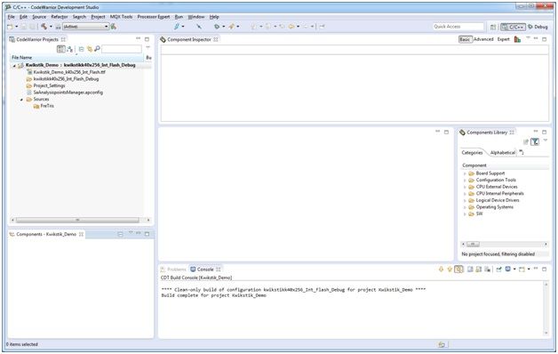

briancook
I am starting with the KWIKSTIK_DEMO_SW_LAB download from http://www.freescale.com/webapp/sps/site/prod_summary.jsp?code=KWIKSTIK-K40&fpsp=1&tab=Design_Tools_....  I am using CodeWarrior 10.5.  I imported the project into CW using the pdf instructions.
The project doesn't build.  I'm not sure if all source files are present.  There are no files in the sources folder.
CodeWarrior is not my normal development environment, the environment is not familar except for its similarities with Eclipse.
I'm involved in a project that is migrating from the KL46 to the K40.  It's important that I be able to build, debug, and flash the K40.

Jorge_Gonzalez
Hello Brian:
The example you mention was developed using MQX v3.7, a very old version of MQX.
This version used to be installed by default in C:\Program Files, and if you are using Windows 7 then the Program Files folder will not allow you to compile MQX libraries. Are you actually using Windows 7, or what OS you have?

briancook
Hi Jorge,
I ended up abandoning the KWIKSTIK DEMO example and downloaded the KWIKSTIK STOPWATCH example. The stopwatch project built without issue and I was able to use j-link to flash and debug. I followed the steps outlined in the KwikStik Demo Lab pdf without success. I tried relocating the MQX install to a different directory. I notice that other users have had difficulty getting the KWIKSTIK DEMO to build. If this example is creating frustration , it should probably be removed from the website.
Anyways, I am no longer stuck. Thanks for getting back to me.
