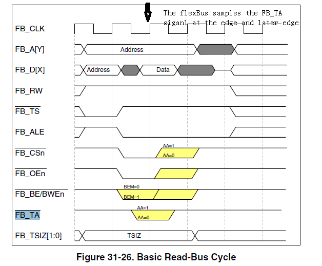

xiangjun_rong
Hi, Karthik,
I see that you use CPLD or FPGA to generate the FB_TA signal, as I have said that you have to do a state machine, the falling edge of CSx can trigger the state machine, you have to use FB_CLK to do the state change of the state machine. You can not generate the FB_TA without FB_CLK involved.
Hope it can help you

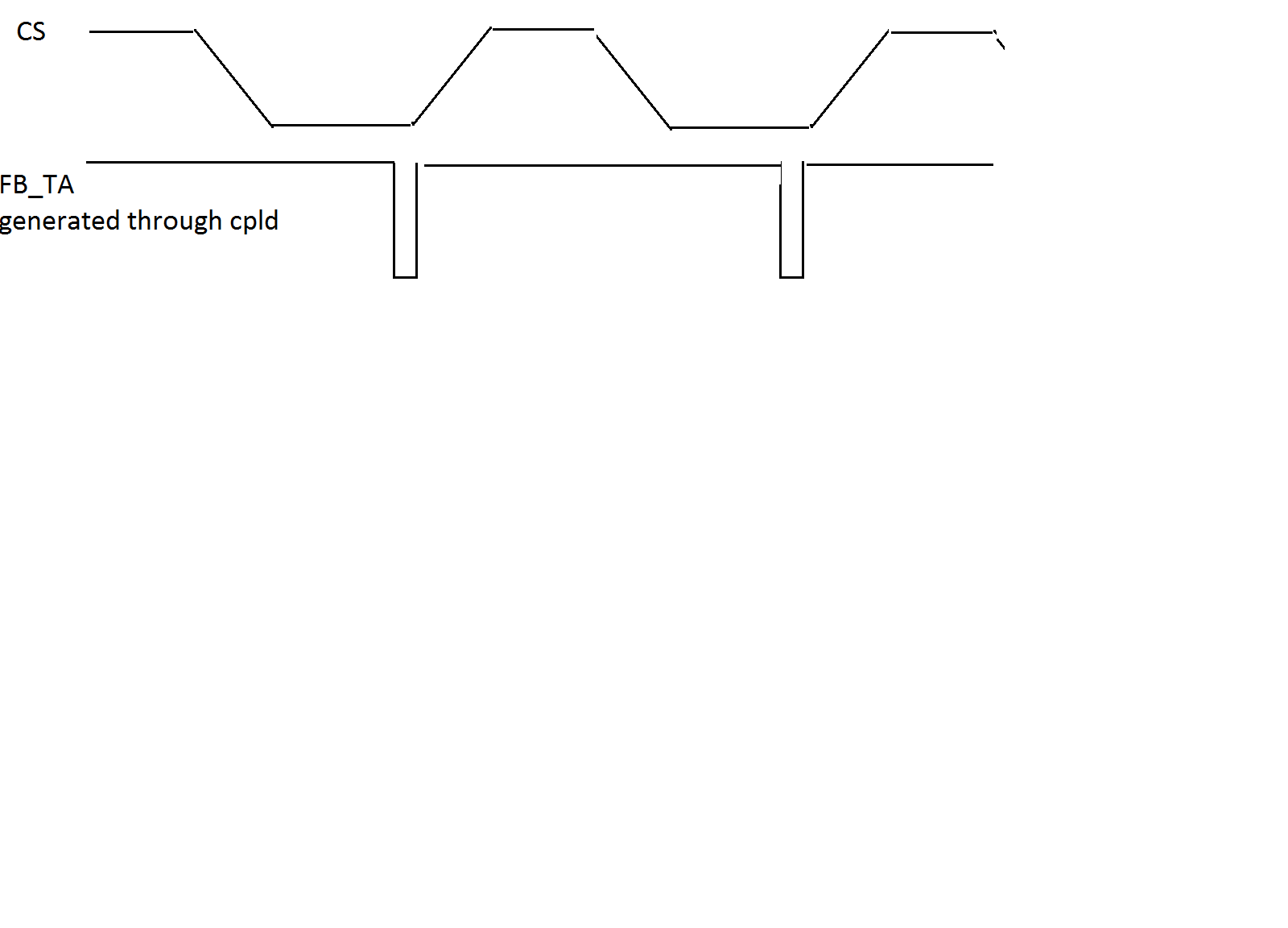

karthikas
Hi, xiangjun.rong,
Thank you for your response.
Yes I am using CPLD to generate FB_TA signal. The waveform exactly look like below , Upon getting first ready signal whole bus transfer getting closed, hence the second CS pulse is not generating. these signals I analyzed by keeping into Auto ACK mode and neglecting the RDY signal(i,e I changed the FB_TA pin mux option to another ).

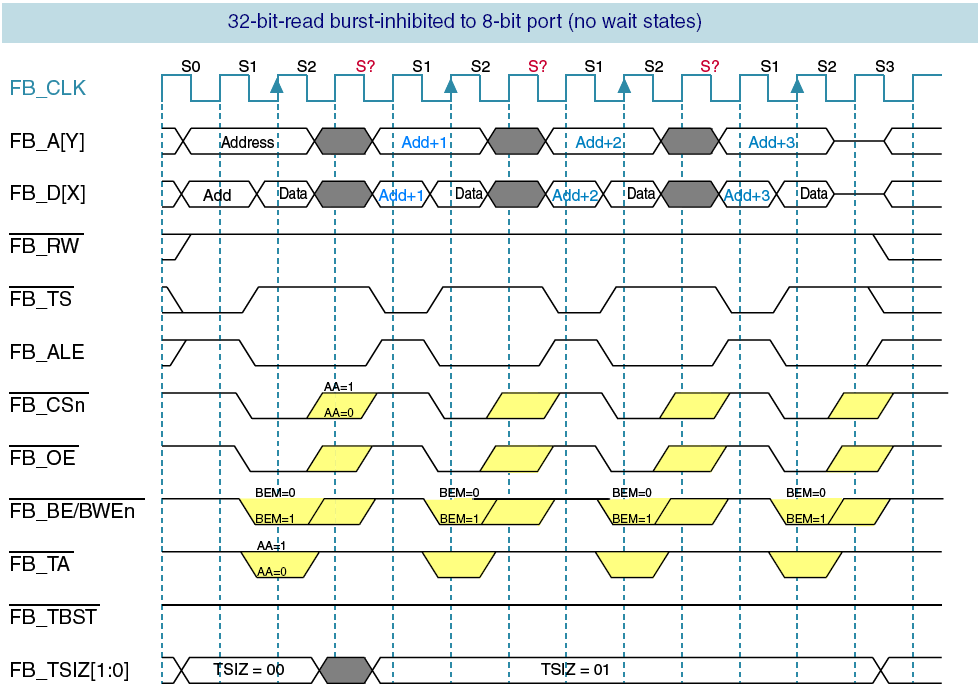

xiangjun_rong
Hi, Karthik,
I do not know how you generate the FB_TA signal without the FB_CLK signal involved, for example, how to control the delay from falling edge of /CS to the falling edge of FB_TA signal. Anyway, you should assert the FB-TA signal from the risng edge of FB_CLK as the following figure. you can refer to the Altera or whatever for the VHDL code.
XiangJun Rong
