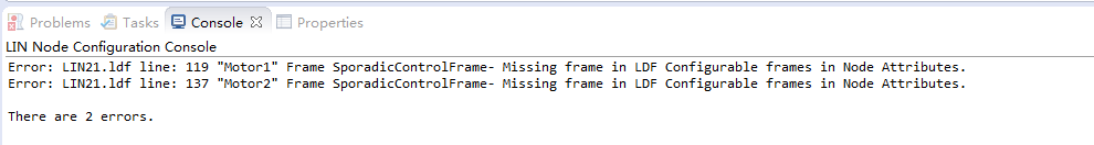

Now in our company,we have a new project.We decide to use KEA128,lin stack package.I find a error.when my lin21.ldf have Sporadic_frames,The NCFTool  can not generate the lin_cfg.h,lin_cfg.c and lin_hw_cfg.h.Now I do not know how to do.

The error message shows clearly that SporadicControlFrame frame should be added to the Node_attributes section.

If users add SporadicControlFrame to the Node_attributes section, he may generate the configuration files.
I hope it helps you.

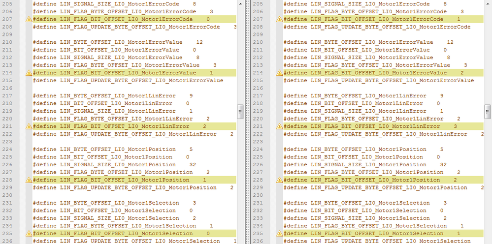

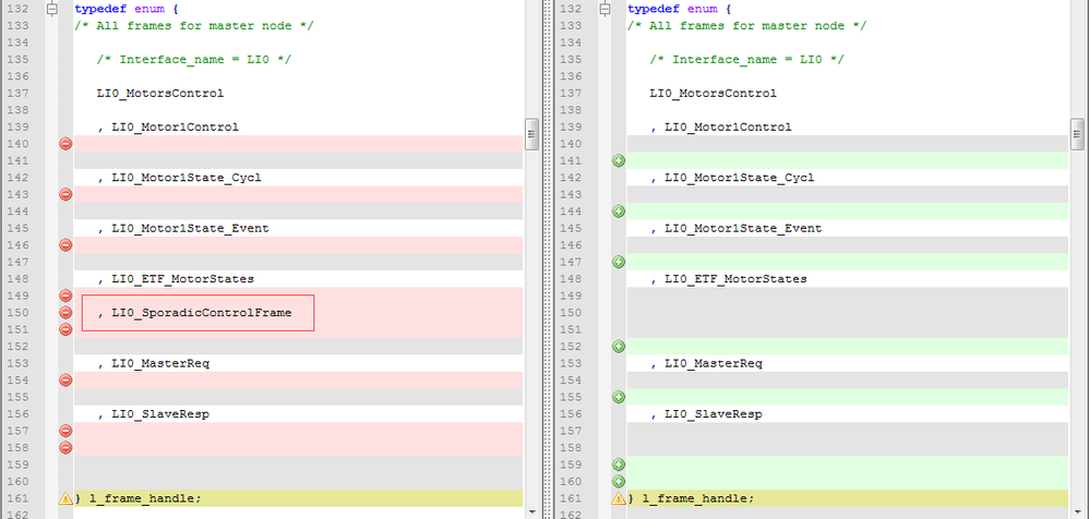

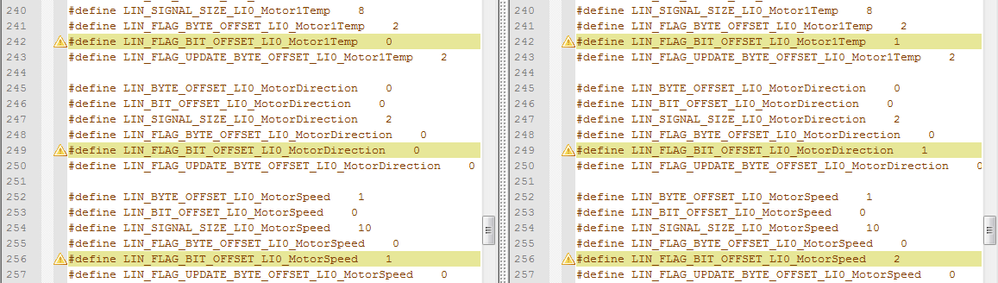

After I add the SporadicControlFrame, the tool can generator the files.But the new generate files have some differences.For example,Both the lin_cfg.c and the lin_cfg.h have some differences with the example files.
I use the blow files to generate the lin_cfg.c,lin_cfg.h and lin_hw_cfg.h.
The cpmpare files is in the FSL_LIN_2.X_STACK\FSL LIN 2.x Stack Package 4.5.7\Examples\Kinetis\KEA128\KEA128_LIN_slave\lin_cfg.
In the lin_cfg.c
In the lin_cfg.h
I do not know those diffenences would cause some influences.
Please give me a feedback.Can I use the lin stack?

The difference is mostly related to some flag offsets that caused by a recent bug fix in NCF Tool.
Actually, the LIN stack team updated all configuration files in examples in release v4.5.8 already. Please use LIN2.x and SAE J2602 Stack Rev 4.5.8
