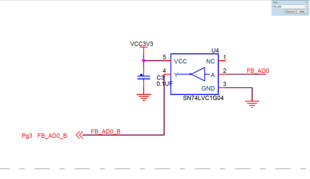

I think you might have misunderstanding with my "A0 trick", in my solution, FB_A0 is connected with LB, and FB_BE_D31-D24(NFC_CS0) is connected with UB, so both of them provide three states for data writes:
  Latch only 8-bits, upper bus (odd address)
  Latch only 8-bits, lower bus (even address)
  Latch 16-bits, upper and lower bus
NFC_CE1 is connect with Nand flash's CS signal, and FB_BE_D23-D16(NFC_RB) can be released for NFC interface as well.
The only problem might be in accessing a 16bit space with misaligned address, for example, accessing address 0x0001 with 16bit width manner, but I think this can be prevented by link file and source code, right?
Take care that FB_ADx will be floating during non flexbus transfer cycles. It should be pull up.
Hope that makes sense,
Please kindly let me know if you have any issue.
Kan

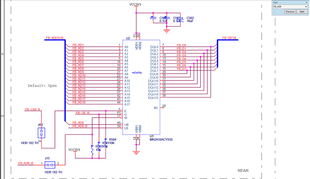

Maybe you have some misunderstanding about the product usage, but there is no need to add a big honking 16-bit bus latch on the flexbus interface, the TWR-MEM provides a good reference for the case of using the lower bus channel for SRAM, in which no BExx_xx signal is used, please kindly refer to the following for details.
Hope that helps,
Kan

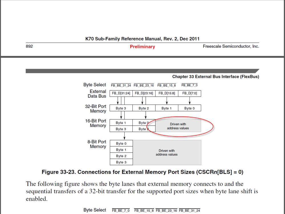

Kan,
Thanks for the example.
The 16-bit latch comes from the fact that when routing data on the lower bus Address and Data are multiplexed on AD0-15, whereas when routing on the upper bus Address and Data are muxed on AD31-16.  In the first case I need to latch AD0-15 (16-bit).  In the latter case I need to only latch AD16 to ~AD23 (8-bit latch depending on memory size) or even no latch at all since A16 to A23 are also available on pins separate from AD16 to AD23 on the 144-pin package.
In your example the interface is an 8-bit databus.  Thus the A0 line can be qualified with decode logic for odd and even bytes.  But this won't work with a 16-bit bus which needs independent control of the upper and lower byte on write cycles.
The K60 memory cycle is already at a big disadvantage since redundant ALE cycles can't be suppressed (except in burst mode), and I would not want to sacrifice the performance of using an 8-bit data bus over 16.

Kan_Li
Pmt,
Providing you are using MR2A16ACYS35 as well, the upper bytes FB_D31-D16 are for SRAM, and FB_BE23_16 should be connected with LB signal, meanwhile FB_BE31_24 should be connected with UB, but for the sake of NFC interface, you may use FB_A0 instead of FB_BE_23_16, so that releases NFC_RB signal, and NFC_CE1 can be connected with Nand flash's chip select signal instead of NFC_CE0(FB_BE31_24).
Kan

Kan_Li
PMT,
Kan

Kan_Li
Pmt,
I think maybe you have some misunderstanding for the above example, the MRAM is a 16bit device, here we use D0-D7 connected with the 16bit port so that we save the total pins used by flexBus, and A0 line acts as the BE signal for upper and lower byte, so that the pin used for BE signal can be used as other function, for example, the RB signal for NFC module, and if you don't have such kind of concern for the pin number limitation, you may connect D0-D15 to the MRAM device, other connection can still keep the same as TWR-MEM.
Kan

Kan_Li
Hi Pmt,
K60120M does implement an arbitration scheme that allows for sharing between the FlexBus and NFC; however, this sharing is really only used for the NFC data lines/FlexBus AD lines and the NFC_WE and FlexBus R/W signals. If you look at the signal muxing table in the manual you can see that these pins only have a single function selection for FlexBus/NFC.  For example, PTB20 function ALT5 is “FB_AD31/NFC_DATA15.” So this is a case where the pin is configured for a FB/NFC mode and dynamically switches between the two.
In the case of the control signal pins that you mention (NFC_CE0 and NFC_RB) the pins for these signals have different programmed functions to choose between the FlexBus and NFC signals on the pins. So for those signal the pin does not dynamically switch between the functions. It is fixed as a FlexBus or NFC pin based on whether you choose ALT5 or ALT6.
and if you only have one device connected with NFC interface, NFC_CE1_b can be used instead, but NFC_RB is a MUST option for NFC module, it is an input signal for this module to check if the flash is ready or busy.
Hope that helps,
