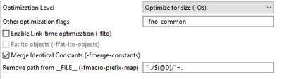

Hi guys,
Happy New Year!, a little bit later jaja...
I'm using a KE04 microcontroller on MCUXpresso (SDK v2.8.0) and since I have the 8kb microcontroller I use the Optimization for size (-Os) but also I want to write the flash memory. The thing is that my program fails when I try to write the memory and I'm using the -Os, with others optimization options works fine.
Does anybody know how to fix this?

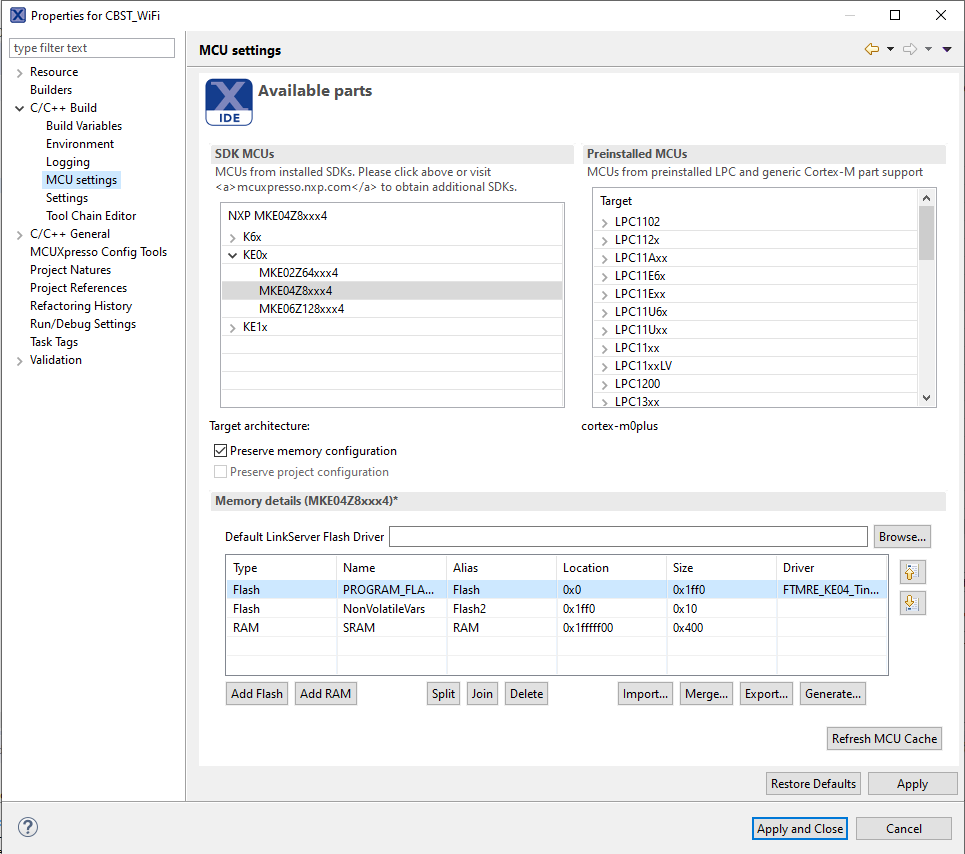

To set the memory area where the info is gonna be saved I used the MCU Settings to split the memory.
And in the Debug.if file added this lines:
    .myNonVolatileVarsBlock 0x00001FF0 :
	    KEEP(*(.MyNonVolatileVars)) /* keep my variable even if not referenced */
	} > NonVolatileVars

PabloRY42
Hi @myke_predko, thanks and sorry for the late response.
This is the memory with the -Os optimization
And without the -Os
	} > NonVolatileVars

First off, you're treating a Flash block as if it is 16 bytes - the actual Flash block size for the KE04 is 512bytes (KE04 Sub-Family Reference Manual) and this is the minimum size that you can erase/write.  The "FLASH_Erase" and "FLASH_Program" methods will try to figure this out for you, but they're only programs and I've seen them have problems with figuring out arbitrary addresses.  I recommend always explicitly doing Flash operations on sector boundaries and performing the operations on the full sector - this means that you should be erasing/programming the entire last sector (you're going to do it anways when you do 16 bytes if the methods work properly).
Secondly, I'm very sure that splitting up the FLASH the way you have (with no driver on the second block) will not work properly.  I haven't seen Flash broken up that way before - where did you get that code?
I suggest that you look at what's returned from "FLASH_Erase" and "FLASH_Program" when the -Os flag is active and missing?
If I were doing your application, I would use code that looks like:
uint32_t* flashSize;
                        FLASH_GetProperty(&s_flashDriver
                                        , kFLASH_PropertyPflash0TotalSize
                                        , flashSize);
uint32_t  lastSector  = *flashSize - FSL_FEATURE_FLASH_PFLASH_BLOCK_SECTOR_SIZE;
uint8_t   SystemNonVolatileVars[16]
//todo: Load the SystemNonVolatileVars array with the required data to save
                        __disable_irq();
status_t  eraseStatus = FLASH_Erase(&s_flashDriver
                                   , lastSector
                                   , FSL_FEATURE_FLASH_PFLASH_BLOCK_SECTOR_SIZE
                                   , kFLASH_ApiEraseKey);  //erase the sector
status_t  ProgmStatus = FLASH_Program(&s_flashDriver
                                    , lastSector
                                    , SystemNonVolatileVars
                                    , FSL_FEATURE_FLASH_PFLASH_BLOCK_SECTOR_SIZE);  // Program the sector with the nonVolatileVars
                        __enable_irq();
I can't think of any reason why you would want to have a separate Flash area defined in your MCU settings and when I look at your screen shot, it doesn't have a driver assigned to it (which could also be your problem).
Could you:
  1. Remove the explict "NonVolatileVars" block in your "MCU settings" - just have a single, contiguous Flash area that goes to 0x2000 and uses the default driver.
  2. Try my code above with -Os active and missing.  Note the values of eraseStatus and ProgmStatus upon the erase/program methods' return.
Let me know how you make out.
Good luck,
myke

I thought that it was necessary to split the FLASH in order to have an specific area for this variables and other to the code, I really don't remember where I got the idea to split the memory that way.
I did remove the "NonVolatileVars" block and tried your code, but I still have the same problem, so I compared my code with the example, run some test and noticed two things:
1. I had my "SystemNonVolatileVars" in the main, like a local variable, so I made it global and then the code works correctly with and without the -Os optimization. The functions return success.
2. If I wanted to have my variable as local (in the main), it has to be "static", other way the HardFault appears, however I stiil don't know why is that, Do you have a clue?
Thank you for your time and help!
