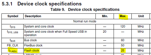

I have seen a new data sheet release (13.10.2015) where the Flash speed in RUN mode shows 26.67MHz so this speed is OK:

Here's an interesting point:
From the K22F120's user's manual as typical option for faster speeds in RUN mode -
From the same devices' data sheet:
Therefore I wouldn't use the recommendation from the user's manual but instead use maxium 20MHz flash clock!
Mark
