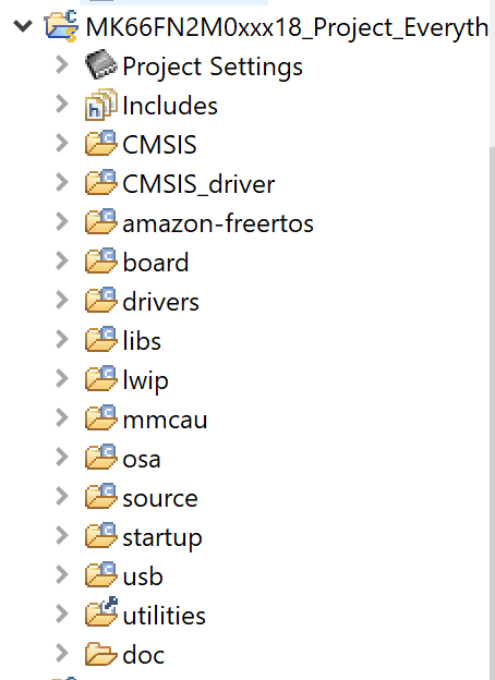

I am trying to add FatFS driver but I couldn't find it when I was creating a new project thru SDK wizard.
I actually added all the available drivers and everything else on SDK wizard too but still there wasn't FatFS.

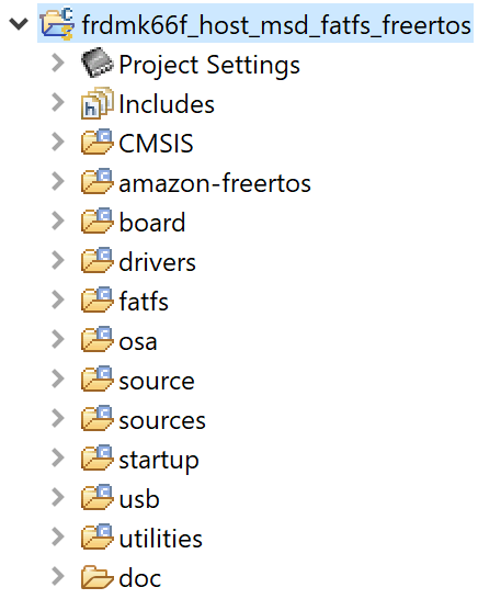

However, there is still a SDK example that is using FatFS.
(I made sure that OpenSDK for K66F includes FatFS middleware too. )
does anybody know where I can add it?
Thanks.

Fatfs is under the middleware components tab, not under drivers. Please see picture below

Under middleware tap, I can only see "Network" and "Security".
Do I need to include other middleware when I build SDK? I remember 3 middlewares were included as default and I added freeRTOS on the top of them.
Thanks.
Jaeyong

Yes, you need to make sure fatfs component is selected when you build SDK.
