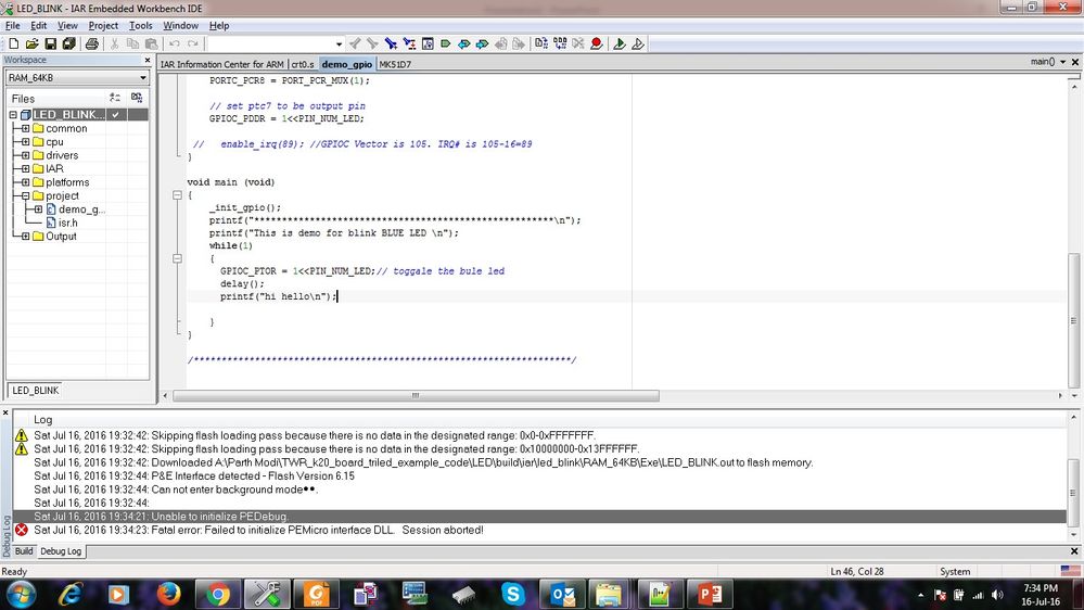

I have freescale 's kineties series MK20dx128vll7 microcontroller and i want to program it using the PE micro multilink universal programmer.I used the port B of PE micro programmer for programming this controller. I use the JTAG interface for the programming the MCU and I also use IAR Work banch for development .
I am facing the problem in the target detection and programme the controller.I also tried to dump a program using SWD interface.I also follow the step as per the described in the PEmicro multilink univesal user guide.

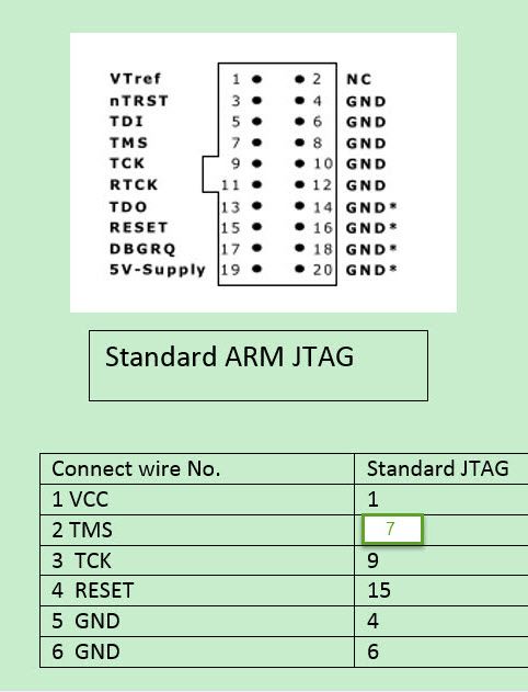

    Which pin you connect to your chip in the P&E multilink?
  PORTB is the standard ARM JTAG interface, if you wan to use the SWD to debug your MK20DX128VLL7, you need to use these 5 pins in PORTB:
VCC is connect to 3.3V, TMS is connect to MCU SWD_DIO, TCLK is connect to MCU SWD_CLK, reset need to connec to the RESET_b pin, then connect the GND together.
  Please check your pin connections, if the pin is connect wrong, you can't download code successfully.

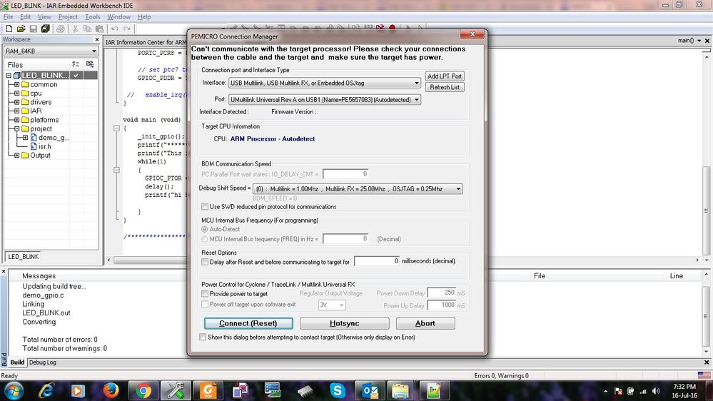

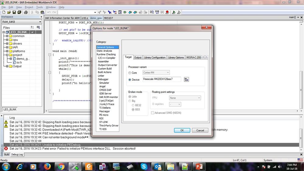

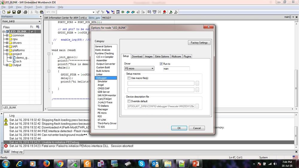

-Please see the detailed screenshot of error and i also send the IAREW's setting's screenshot.
-Here target detection yellow LED did not turn ON.

  It seems you are using the TWR-K20D72M board's flashloader, actually, tower board is using K20DX256VLL7, this flash and RAM all larger than your chip.
  So, to confirm it is not the software problem, could you download a KDS IDE and create a barebone project, and download it again?
