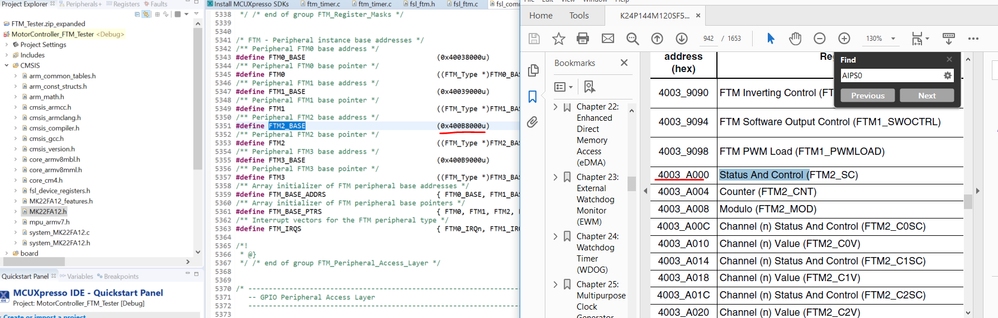

I've a strange problem with FTM timer on my custom board based on MK22FN1M0AVLH12.
I'm be able to initialize all FTM timer except FTM2.
In particular the application crash when it execute FTM_SetPwmSync on FTMInit function.
The strange thing is that it seems non correctly clocked though the clock is previously enable
also in the FTMInit function.
I read in this post that there is a bug in SDK 2.3.1 that is the last version for this micro
Bug in 2.3.1 K22 SDK for FTM Input Capture
Is this the same problem?
How come the latest version of the SDK is 2.3.1 for this micro while for the FRD_K22 card it is 2.7.0?
Can I do easily a manual update or no?

Yes. But don't forget modifying the linker file. The same k22 series also has the flash and sram's difference.

Actually you are right. Some sdk is lack of our maintenance.

LArmstrong1985
Ok,
the error is also in the Reference Manual (Document Number: K22P64M120SF5V2RM Rev. 5, March 2015) for
this specific package.
Is possible to copy SDK 2.7.0 from example project of another micro like the FRDMK22 board?
It seems to me that the SDK are generic and not related to the single hw...
