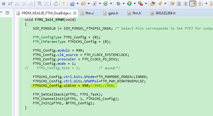

Double Edge sampling using FTM2(CH2&CH3) of S9KEAZN64AMLC , sample the period of  pwm signal .
When the duty cycle is greater than 95%,The measurements are incorrect.("20KHz" has been misidentified as "10KHz ").
Can the IC measure the period of a signal with a duty cycle greater than 95% ? If it can be collected, what should we pay attention to when designing?

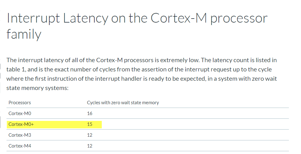

   Please note, the FTM double edge sample,two edges detect is also using the same FTM2 interrupt ISR.
  From this link:
   Beginner guide on interrupt latency and Arm Cortex-M processors - Processors blog - Processors - Arm...
You can get that:
  That means, the interrupt latency+ your ISR interrupt service code time should smaller than the 5%*20K= 2.5us.
  So, if your core clock is 40Mhz, then you can check your ISR serive code, whether all the execute time is larger than 2.5us when you can't detect the correct frequency?
   Because if your ISR execution time is very long, when the next edge interrupt happens, you will lost the interrupt, it will have problems. So in your ISR, code should be as small as possible, save the execute time.

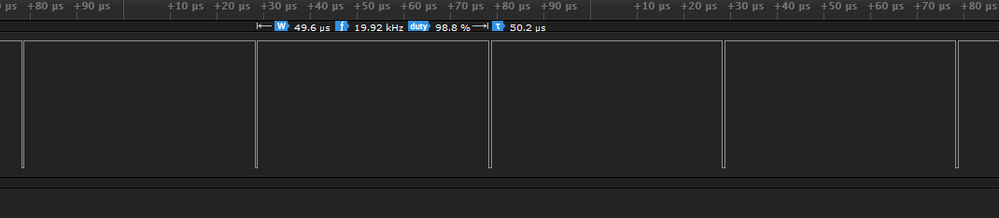

  Today, I do more testing, now it can capture upto 99%(990/999=99%).Even 40Khz.
Please check my test result:

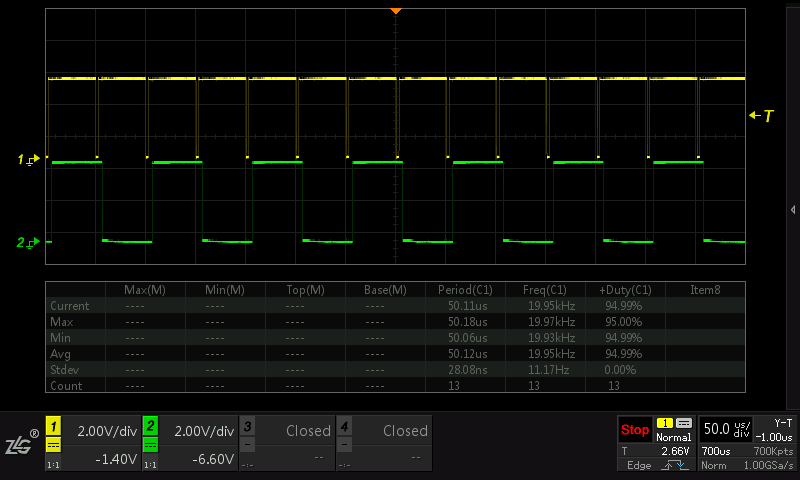

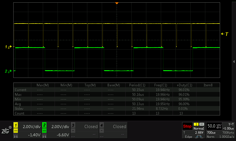

We configure the Bus clock 20MHz,Core clock is 40MHz. Using the S32 Design Studio for ARM Version 2018.R1 development environment. Run the  code of appendices.
The current configuration:Using the FTM2_CH4(detect rising edge,disable interrupt)、FTM2_CH5(detect falling edge,enable interrupt).FTM1 output PWM(20KHz),Put I/O toggle in input capture interrupt.
1.When the PWM duty is 95%,can be captured normally,and into interrupt(execute IO toggle);
2.When the PWM duty is 96%,an interrupt will be lost.
Question:Why lose an interrupt? We only enable the interrupt of FTM2_CH5(detect falling edge). The time interval is 50μs of ever falling edge.

  I checked your code, I find your ISR code is really containing too many code.
void FTM2_IRQHandler(void)
if(FTM_Callback[2])
FTM_Callback[2]();
void FTM2_Task(void)
    static uint8_t flag = 0;
    static uint16_t old_Ch0Value, new_Ch0Value;
    OUTPUT_TOGGLE(PTF, PTF7);
    FTM_ClrChannelFlag(pFTM2, FTM_CHANNELPAIR2);
    FTM_ClrChannelFlag(pFTM2, FTM_CHANNELPAIR2+1);
 FTM_MemMapPtr pFTM = (FTM_MemMapPtr)FTM2;
 u16Ch0Value = pFTM->CONTROLS[4].CnV;
 u16Ch1Value = pFTM->CONTROLS[5].CnV;
 counts= (u16Ch1Value - u16Ch0Value);
    flag++;
    if (flag == 1)
        old_Ch0Value = u16Ch0Value;
    else if (flag == 2)
        new_Ch0Value = u16Ch0Value;
        period = (new_Ch0Value - old_Ch0Value);             /* 20M */
//        printf("\n The input wave period is %i us\n", period);
        flag = 0;
// period=(((.000000167)*(counts))*(1000000))*(2);   /* Operation to get the period of the output */
// printf("\n Dual edge capture end. The input counts are %d\n",(counts));
// printf("\n The input wave period is %i ms\n",period);
// pFTM->COMBINE |=  FTM_COMBINE_DECAP2_MASK |FTM_COMBINE_DECAPEN2_MASK;
I suggest you move some code outside the ISR.
eg, in the ISR, just store u16Ch0Value, u16Ch1Value, clear the flag.
Then define one flag, which used to indicate the FTM2 interrupt is entered.
Then in your main code, when detect the FTM2 ISR entered flag is set, do the GPIO toggle, and other calculation code.
If it is still not enough, you can delete your callback, do the FTM channel clear and the value store in the void FTM2_IRQHandler(void) directly.
Please try it again.
