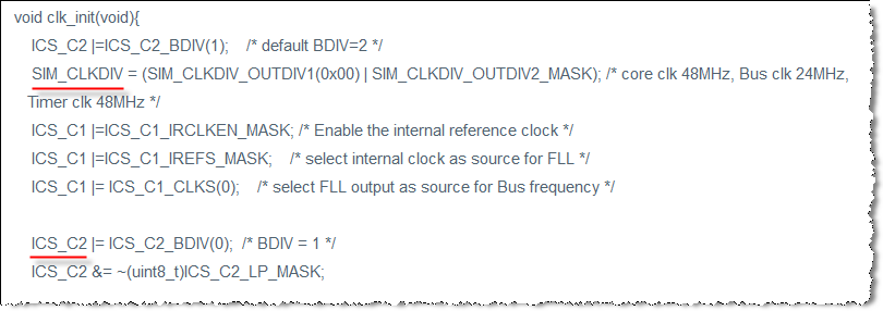

Hello all,
i am trying to setup the FTM modul to generate 50us interrupt. The FTM works with 48MHz and i select a prescaler of 64. that means the timer has a period of 1.3333us. So to have 50us i shoul set the channel counter (FTMx_CxV) to 37. But what i measure is an 25us interrupt?? it looks like the FTM clock source is 24MHz and not 48MHz! here ist hte Clock setting and the FTM init code:
void clk_init(void){
    ICS_C2 |=ICS_C2_BDIV(1);    /* default BDIV=2 */
    SIM_CLKDIV = (SIM_CLKDIV_OUTDIV1(0x00) | SIM_CLKDIV_OUTDIV2_MASK); /* core clk 48MHz, Bus clk 24MHz,    Timer clk 48MHz */
    ICS_C1 |=ICS_C1_IRCLKEN_MASK; /* Enable the internal reference clock */
    ICS_C1 |=ICS_C1_IREFS_MASK;    /* select internal clock as source for FLL */
    ICS_C1 |= ICS_C1_CLKS(0);    /* select FLL output as source for Bus frequency */
    ICS_C2 |= ICS_C2_BDIV(0);  /* BDIV = 1 */
    ICS_C2 &= ~(uint8_t)ICS_C2_LP_MASK;
    OSC_CR = 0x00U; /* disable OSC Module */
    while((ICS_S & ICS_S_IREFST_MASK) != 0x10U) { /* Check that the source of the FLL reference clock is the internal         reference clock. */
    while((ICS_S & 0x0CU) != 0x00U) {    /* Wait until output of the FLL is selected */
void FTM2_Init(void){
    SIM_SCGC |= SIM_SCGC_FTM2_MASK;    /* enable clock for FTM0 _Freescale_*/
    FTM2_SC |= FTM_SC_PS(6);    /* select prescaler -> 64 _Freescale: Value adjusted_*/
    FTM2_C0SC |= FTM_CnSC_CHIE_MASK; /* enable channel 0 interrupt _Freescale_*/
    FTM2_C0SC |= FTM_CnSC_MSA_MASK; /* channel works in output compare mode _Freescale_*/
    FTM2_C0V = 37;    /* every 50µs */
    FTM2_SC  |= FTM_SC_CLKS(1);    /* FTM0 uses system clock _Freescale_*/
what could be the problem? if i assume that the Timer clk is 24MHz every thing works fine.
thank you for helping.
Hani

Hi Hani,
Please refer the code shown below:
/* ICS_C2: BDIV=0,LP=0 */
  ICS_C2 &= (uint8_t)~(uint8_t)((ICS_C2_BDIV(0x07) | ICS_C2_LP_MASK));
Robin

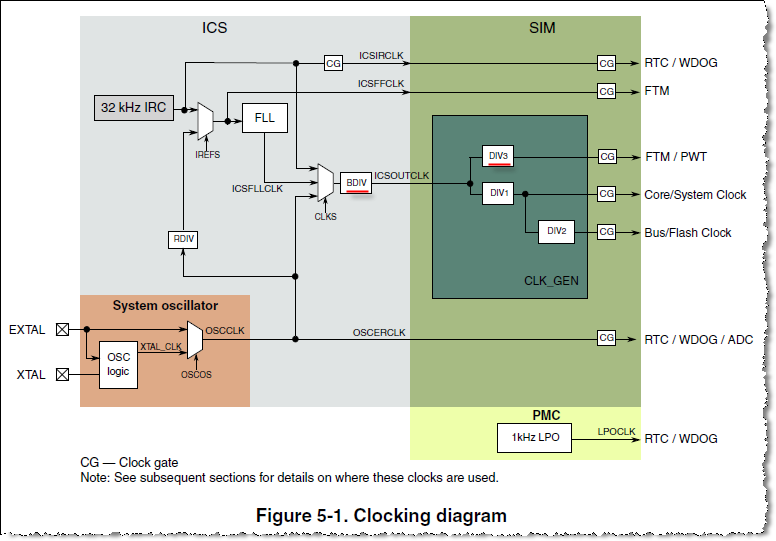

Robin_Shen
Hi Hani,
Since you are using KEA ZN8, Timer clock(ICSOUTCLK divided by DIV3) clocks the FTM and PWT modules.
You need to check whether the SIM_CLKDIV[OUTDIV3] and ICS_C2[BDIV] are correct configured.
I didn't see the SIM_CLKDIV_OUTDIV3 in clk_init().
You can't set the value of BDIV like that. Since the BDIV is default to 0x01, it will still equal to 0x01.
Robin

hanisamara
Hello Robin,
Thank you for answer.
for OUT_DIV3 i set it many times to 0, but it dose not help.
for the BDIV i set it in the code to be zero, i.e. ICSOUTCLK divided by one. (ICS_C2 |= ICS_C2_BDIV(0)).
My configuration:
1. FLL out = 48MHz
2. BDIV = 1 default divide by 2
3. ICSOUTCLK = 24MHz
4. DIV1=0 (divide by 1)
5. DIV2=1 (divide by 2)
6. DIV3=0 (divide by1)
7. BDIV = 0 (divide by 1) --> ICSOUTCLK = 48MHz
         -- FTM/PWT clk = 48MHz
         -- Core clk = 48MHz
         -- Bus clk = 24MHz
but as i told Mark in the previous Post, i donot understand why we should enable the bus clk for the FTM in the FTM init code??! (SIM_SCGC |= SIM_SCGC_FTM2_MASK;    /* enable bus clock for FTM0 _Freescale_*/)
if i remove this line the timer did not started at all!
Hani

Robin_Shen
Hi Hani,
Robin
4,052 Views
hanisamara
Hello Robin,
Thank you very much. You are right, it is an OR operation, so the 0x01 still remains. It works fine now.
Hani

mjbcswitzerland
Specialist V
Hani
The timer module in the Kinetis KEA parts is clocked from the BUS clock, which you have set to 24MHz.
If you are getting values for a 24MHz clock it sounds as though all is normal.
Mark
4,052 Views
hanisamara
Hallo Mark,
thank you.
in the reference manual as you can see in Robin post, you can configure the FTM/PWT to have 48MHz! but what this line means in the FTM_init:
it enables the bus clock for the the FTM modul?! i took this code from Freescale getting started document.
Hani
