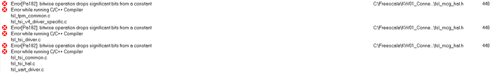

When I plug the USB cable for the FRDM-KW019032 board into a windows 10 computer a file pops up in the MBED folder for the board that says 'Fail'. When I open the Fail.txt all it says is Timeout. Is there a way to get rid of this error? Is this a critical error to the board functioning properly? I ultimately want to get this board to function as a receiver for an FXTH870 development board.
Also, when I was trying to follow the quick start guide that comes with the FRDM-KW019032 board (FRDM-KW019032|Freedom Development Platform|Kinetis®|NXP ). I am currently at step 3.2, however, when I am trying to make the file I get 50 error messages - some of which are repetitive. The picture below shows some of the errors. I want to be able to get rid of these so that I can run the connectivity software to see if the board is working properly.

The boards do not appear to work with Windows 10. If I plug the boards into a Windows 7 computer I do not get the Timeout Errors however the boards are still not working. What can I do to use the boards on a Windows 10 computer?
I am using version 7.40.2 of IAR. When I try to run and debug the connectivity test on the Windows 7 computer I get an error which says 'Fatal Error: Reading CPU Status Failed'. I believe this error is related to the fact that the Reset LED never turns off. How can I get around this error?

Sorry for the late reply it seems there was an issue  k22 firmware which was not fully compatible with Win10.
Could you please update it? The k22 binary has been updated in the OpenSDA website.

I found that, the bootloader bin should be K22 just as you refered, and the interface bin followed should be K26L.

Hello, I met the same trouble as you before about "bitwise operation drops...", and later I used 7.80.4 and succeed to compile and debug, in win10 with IAR.  But, I still I found the fail.txt if I just drag and drop a bin file to the MBED folder, and the MBED repeat reload. I don't know why.
