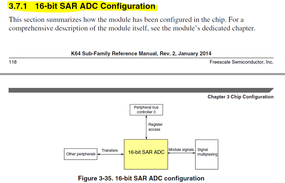

I'm working on a project with the K64, and the board has analog inputs tied to pins ADC0_DP1, and ADC0_DM1 pins. The are not to be measured deferentially, but single ended. I don't see how to configure the part for this setup. Can DPx and DMx pins both be used to measure single ended? Or only one of them (DPx?).
Another question is the reference manual says "For ADC connections specific to this device, see the chip-specific ADC information". WHERE is this?
The reference manual is K64P144M120SF5RM, and its in chapter 35.2.5 where is says to see the above about the DADPx and DADMx pins.

Ok, so it looks like DM1 pin can be single ended, I just need to select channel AD20. I'll try it tomorrow.

Yes,

In fact, the same for all Kinetis K, KV, KM, KL parts (although not all channels are necessarily available).
