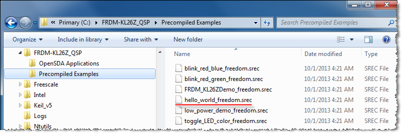

Hi Eyal,

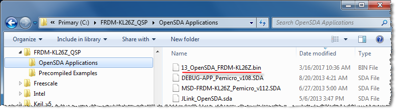

Flashed with the latest Segger JLink software(13_OpenSDA_FRDM-KL26Z.bin).

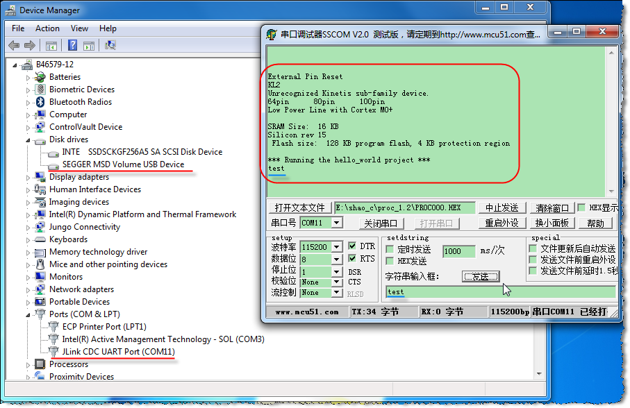

Test the "hello_world_freedom.srec" on FRDM-KL26Z REVB, the virtual COM port can send and receive message.

You can test that example, I have attached "hello_world_freedom.srec" and "13_OpenSDA_FRDM-KL26Z.bin".

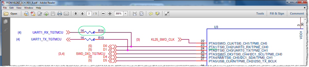

If UART0 receive still didn't work, you may need to check the UART1_RX_TGTMCU signal. Make sure the PTA1(Pin23) of KL26 is well connect to PTC4(Pin25) of PK20DX128VFM5.
