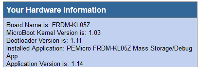

i have problem with my FRDM-KL05Z board.
I try to use this board with Kinetis Design Studio 3.0 with this board, i have created a new project and i have selected the "MKL05Z32VFM4 in QFN 32-pin package" but when i go to program the board with a basic sw program appear to me the error "Error 17926. Target type MCU mismatch, Unexpected processor type detected. Aborting debug session."
As you can see in the attached image in the SDA interface the MCU is correct.
Why i am not able to use KDS in debug mode?
Someone could help me?

Hi Diego,
Your project settings look ok.
As a reference, I have attached you a project I'm using with KDS v3.0.0. Can you check if this one works for you?
It is as well on GitHub (Examples/KDS/FRDM-KL05Z/FRDM-KL05Z_PEx at master· GitHub ).
What firmware do you have on your board (click on SDA_INFO.htm on your FRDM-KL05Z device)? I have
Note that it should show 'FRDM-KL05Z Mass Storage/Debug App. Maybe you have loaded a wrong firmware? That would explain your error message.
