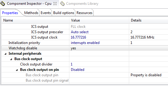

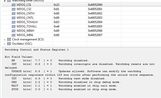

WDOG is diabled - find below snapshot, LVD is disabled
watch dog disabled in CS1

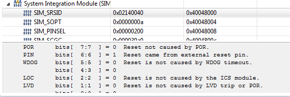

Status of SIM in debug mode

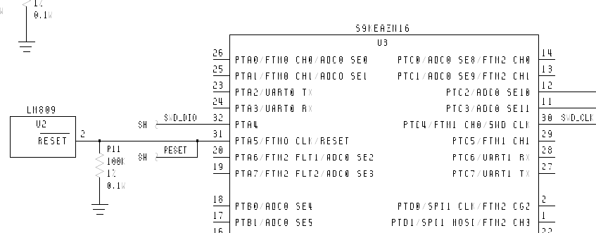

Our actual schematic is :
RESET net goes to debug port.
To debug, we removed LM809 and 100K (pull-down resistor). Reset pin is tied to +5V through 4.7K resistor.
