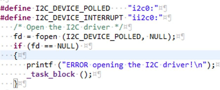

I got the point, but remember that I2C interface allows user to connect/disconnect devices in the bus at any time and the only way to notice when device is not connected is through ACK reception. This is solved in write operation by calling the ioctl function and request for FLUSH_OUTPUT, which allows user to validate if ACK was received.
For read operation, it is quite different. When you call fread function, this function waits until "N" bytes have been received, if they are not received due disconnection for example, function will not return, in this case, you should try to implement different logc. Could you please tell me which I2C mode you are using? You can use either polling or interrupt mode, by default, both drivers are enabled but user choses which one will be used when calls the fopen function:
I2C mode.jpgI haven't analized I2C driver deeper, but i think that when I2C poll driver is used, you should be able to use fread function and when data is not received returning value should be zero. Using this mode, you can identify when slave is not responding and notify upper layers.
I hope this can help,
Isaac

I'm working in Interrupt mode.
If I well understand, I have two way to solve my problem:
1- Use Polling  Mode (fread value will always be Ok If device connected, else return 0)
2- Use a Write function before read
Are they other simple way?
