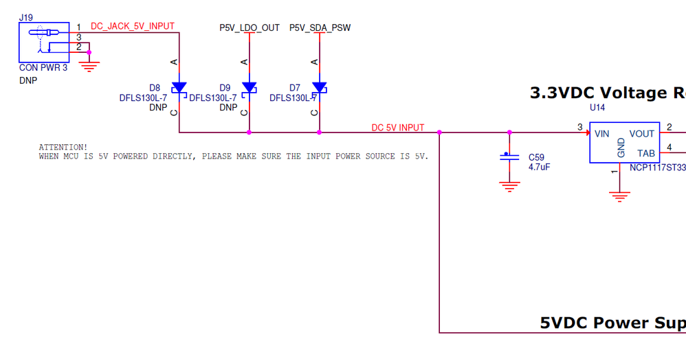

Hi All,
Could you please let me know the procedure to power FRDM-KE15Z from external DC source.I populated the DC jack & tried booting with 5v, 1A  supply but its not working.
I am not able to see any detailed user guide for FRDM-KE15Z
Abhilash vR

     2. About the DC jack.
     Actually, the out of factory FRDM-KE15Z board didn't solder the J19, D8. You said you populate the DC jack, but I think you didn't solder D8, then your external 5V won't power the chip.  I have tested it on my side, I input a 5V directly to D8 C pin, then the board is powered on, and the code is working.
   So, please check your D8.
Wish it helps you!
