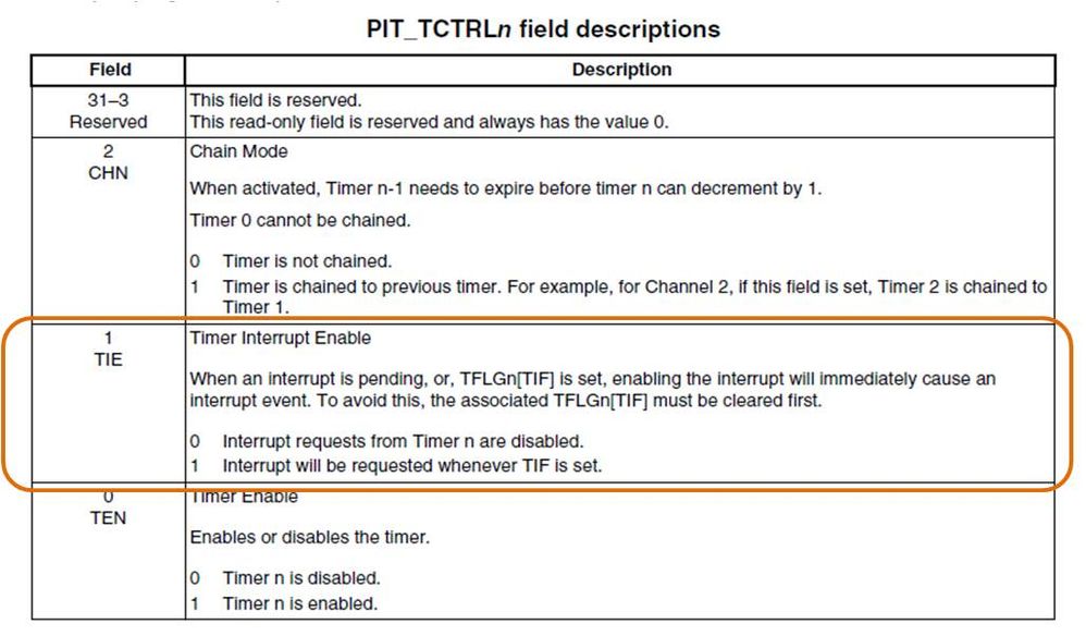

  • When Configuring your Peripheral (In my case I will use PIT_CH0 as Interrupt source) you have to set the right flags to request an interrupt:
  • Then, you must enable its respective vector in the NVIC module. This steps consists to write to specific ISER register and set its priority:

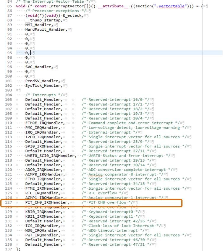

  • At this point, how does the MCU knows that PIT_CH0_IRQHanlder corresponds to PIT0? Well, there is a table located at: Project_Settings > Startup_Code > kinetis_sysinit.c (for CodeWarrior 10.6 and bare metal project)
  • In this source file, there is a table where all ISR are declared, so make sure your ISR is named exactly the same as in InterruptVector table:
  • After following these steps you shouldn’t have any problems on attending the specific ISR.

scofieldwolff
Thanks, I solve the problem. I set RTC interrupt exactly, but I forgot to set my ISR code to the interrupt vector.   However, I take a Macro for linking my interrupt service code to interrupt vector. In the interrupt souce file, I do it as follow.
#ifndefine RTC_IRQHandler
#define RTC_IRQHandler  RTC_Isr  // RTC-Isr is my interrupt code.
extern void RTC_Isr(void);
Before making  the Macro ,  I comment the RTC_IRQHandler Func. declaration.
