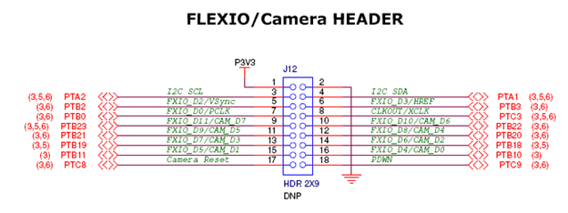

One of the new features that can be found on the FRDM-K82F is the FlexIO header. It’s be specifically designed to interface with the very cost-efficient OV7670 camera, and uses 8 FlexIO lines to read data from the camera. By using the FlexIO feature, it makes it easy to connect a camera to a Kinetis MCU. A demo is included with Kinetis SDK 1.3 which streams the video data from the camera to a host computer over USB.

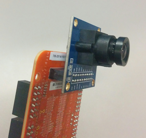

First you’ll need to setup the hardware. An 18 pin header needs to be installed on the *back* of the board. The camera is oriented this way to allow for use of shields on the top, even if the camera is being used. This way the functionality could be extended with WiFi or LCD shields.
After the header is soldered on, plug in the camera. It will look like the following when complete:

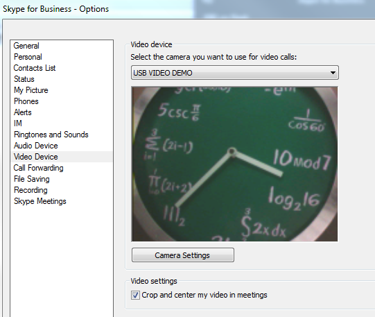

After programming the K82, unplug the USB cable from J5 (OpenSDA) and plug it into J11 (K82 USB). The board will enumerate as a generic USB video device called “USB VIDEO DEMO”. You can then use this device with any video capture software, like Skype or Lync.  Here's a shot of the clock in my cube:
The resolution is 160*120, the video image format is RGB565. You may need to manually adjust the focus by rotating the lens on the camera.

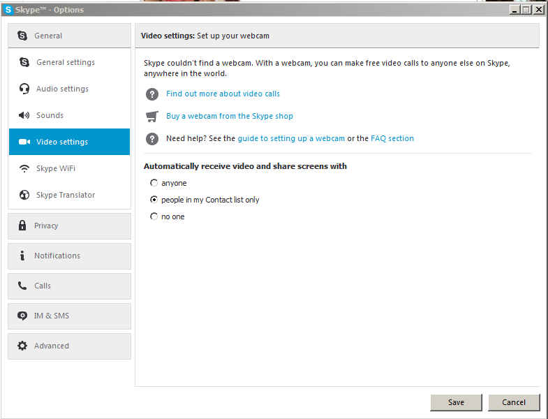

I've soldered my OV7670 module in FRDM-K82F, builded the project and all the libs in KDS, flashed it to target and I can see the USB VIDEO DEMO device on my Window's device manager, but when I open Skype, It shows that it canot find a webcam.Seem that it tries to get frames from the USB VIDEO DEMO device, but as it don't get any, it shows this message:
I tried it in 2 Windows machines (one with Windows 7 and other with Windows 10)

I got it working using GraphEdit
