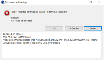

I cannot download the SDK examples from MCUXpresso to the FRDM-K64F evaluation board consistently, I need to plug in and out the USB several times to make it go through.
I always have the following error:
The red LED is always on near the green LED when the issue happens.
I just use the SDK example and debug from the MCUXpresso, nothing else.
Could somebody suggest what might happen here?
Thanks a lot for your help

Hi @niz
It might be that the middleware in your board is outdated. Please look through this guide and update the OpenSDA version;
https://www.nxp.com/design/software/development-software/sensor-toolbox-sensor-development-ecosystem...
After this, try installing the SDK again onto your board. If this doesn't work, please tell me to search alternatives.
Best regards, Julian

Thanks for the info
It works.

Hello Julian
I got another FREEDOM64F board, and after doing the same updating the SDK process, my PC can detect the FRDM_K64FD in the Portable Devices, however, the red light is always on and the MCUXpresso cannot detect the SWD, is there any way to take care of that issue?

Hi @niz,
The constant red LED means your boards is constantly resetting. Here is a similar case you can consult for the solution: Solved: New FRDM-K64F resets after 30 seconds - NXP Community
Hope it helps!
