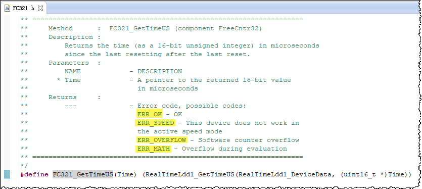

Yeah, the function is for a 16 bit variable as you can see in the automatically generated function:
**     Method      :  FC321_GetTimeMS (component FreeCntr32)
**     Description :
**         Returns the time (as a 16-bit unsigned integer) in milliseconds
**         since the last resetting after the last reset.
**     Parameters  :
**         NAME            - DESCRIPTION
**       * Time            - A pointer to the returned 16-bit value
**                           in milliseconds
**     Returns     :
**         ---             - Error code, possible codes:
**                           ERR_OK - OK
**                           ERR_SPEED - This device does not work in
**                           the active speed mode
**                           ERR_OVERFLOW - Software counter overflow
**                           ERR_MATH - Overflow during evaluation
#define FC321_GetTimeMS(Time) (RealTimeLdd1_GetTimeMS(RealTimeLdd1_DeviceData, (uint16_t *)Time))

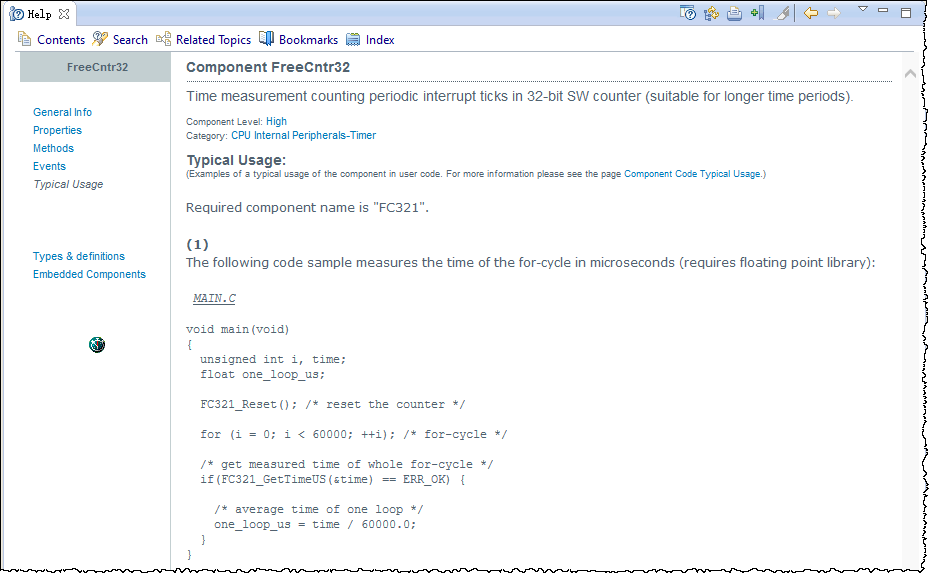

Have you test the Typical Usage of FreeCntr32?
void main(void)
  unsigned int i, time;
  float one_loop_us;
  FC321_Reset(); /* reset the counter */
  for (i = 0; i < 60000; ++i); /* for-cycle */
  /* get measured time of whole for-cycle */
  if(FC321_GetTimeUS(&time) == ERR_OK) {
    /* average time of one loop */
    one_loop_us = time / 60000.0;
I don't have the FRDM-KE02Z40M board, so I can't debug it. If still not work, have you try to select other timer?(for example: PIT or FTM)

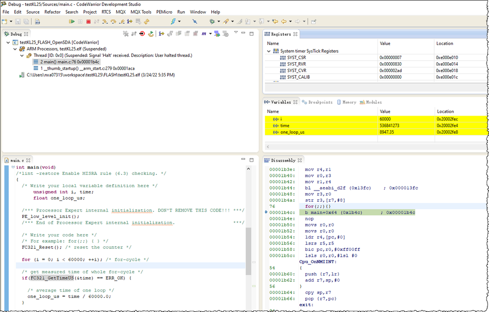

It works on FRDM-KL25Z board. Maybe you can compare the register of Systick.
