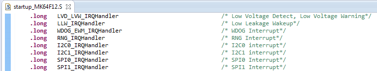

Jorge_Gonzalez
Hello Dave:
With KDS/KSDK the ISR function pointers are treated differently. The ISR entry names are declared in an assembly file called "startup_<device>.S".
For example a small part of the ISR entries list for K64 is below:
If you are interested on interrupt handling with KSDK I released a document a few days ago: Interrupt handling with KSDK and Kinetis Design Studio
About the videos, you can watch them, just keep in mind that they are a bit old and made for CodeWarrior, some things will not apply for latest development tools (KDS or KSDK).
Regards!
Jorge Gonzalez
