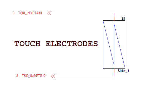

Dear Folks,
I am new to freescale.
I was developing HMI application. I was looking for a evaluation board which has touch input (keys) and uses the kinetis Microcontroller. I would like to get acquainted with TSS library and TSI hardware module of KL05. Kindly suggest me suitable evaluation boards.
I searched for some boards which have touch input interfaced but they use a TSS library and GPIO method to detect the key not the TSI module of the microcontroller.
Thanks & Regards,
Suresh Jaggal.

Hi Suresh
The Freedom kl05 use 2 electrodes TSI0 in8 and 9
You can use them with the TSI module without the TSS library, or you can use them (I recommend it) with the TSI module and the TSS library, a good example is instaled when you instal the TSS library, normally on this folder
C:\Freescale\Freescale_TSS_3_1\examples\FRDMKLXX_DEMO\build\cw\FRDMKL05Z_DEMO
Also you can use PE to create a project that use the TSI module and the TSS library
You can download the TSS library from here TSS
And you can check all the information about the Freedom KL05 here
FRDM-KL05Z
I hope this will help you.
Vicente
