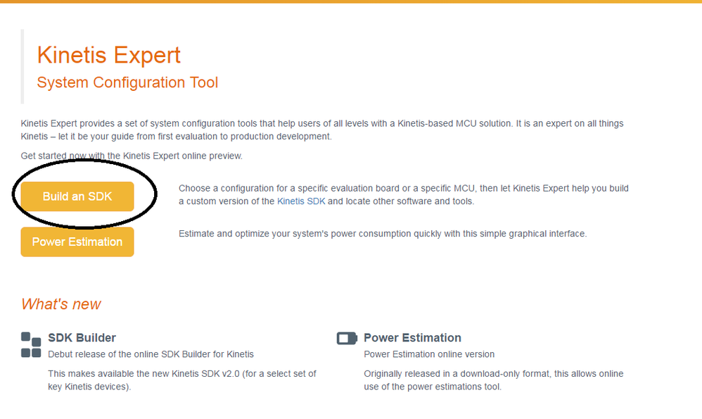

  You can download examples in Keil, search Kinetis Expert in the web, after that log in and select the option "Build an SDK". See the picture below

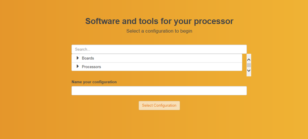

Select the board that you are using and name the configuration

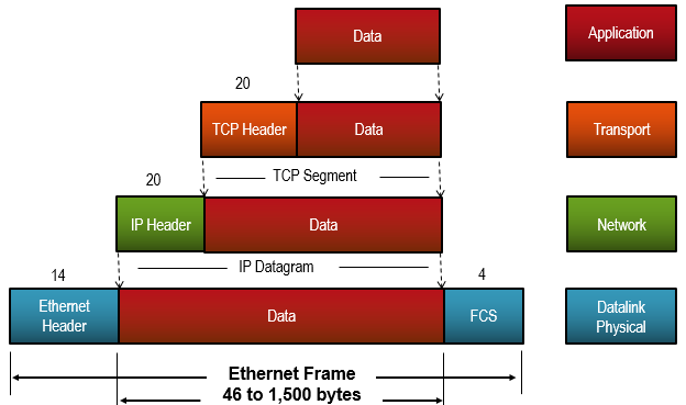

The next image shows you the layers the TCP communication model.
According to the image above, when sending an Ethernet packet the data is generated in the application layer, then Transport Layer protocol header (TCP in this case) is concatenated to the payload, this header contains tracking transmitted data segments, ACK received, unacknowledged data and connection ports, then another header for the Network layer is added including Time to live, source IP and destination IP address. At the end the MCU creates the Ethernet Header containing preamble, source and destination MAC address, and with all that information calculates the Checksum and send the packet.
When receiving data the MCU checks the FCS, then IP header is decoupled and destination IP is compared to evaluate if it belongs to this device, if it doesn´t then the entire frame is ignored. After this the network layer header (TCP in this case) is decoupled and the connection port is checked, the last layer decouples the application header if it exists and gets the payload.
If you try to send Ethernet data without TCP/IP stack, you have to create all the headers each layer one by one manually and it might be complicated.
On the other hand a TCP/IP stack will create all the headers like TCP, IP and you only have to provide the data, and when you are receiving data, a TCP/IP stack will process the headers and give you the payload without all the headers. This is why it is strongly recommended to use a TCP/IP stack, as it makes all that process, and the user can only focus in the application.
