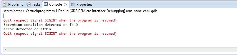

Hello. I am trying to flash the FRDM-K64F using the inbuilt debugger OpenSDA. But I'm getting an error which I have attached in the screenshot. Actually a lot of errors appear quickly on the console and disappear before I can take a screenshot. I'll try to post those also
The steps I have taken are as follows-
1.Installed mbed driver from the website, with the device plugged in as mentioned in its instructions.
2.Installed OpenSDA drivers from PEMicro website, again with device plugged in and all windows explorer windows closed as mentioned in its instructions.
3.Configured Debug Profile as per KDS 2.0.0 User Guide to use PEMicro's OpenSDA debugger.
What could be the problem?

Hello Pratiek Bhadranavar,
it looks you have incorrectly set debugger in KDS.
Please, look at this thread, No port select available in setting a debugger connection if is is your matter.
Also, we have created good tutorial for this procedure, please also check your steps according to Illustrated Step-by-Step Instructions: Updating the Freescale Freedom Board Firmware | MCU on Eclips...

Ira, in another thread on the forum, I found that the FRDM-K64F uses the OpenOCD Debugger, not the OpenSDA !!! I'll try this out and confirm as soon as possible !!!

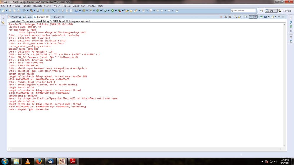

My mistake. It is clearly mentioned in the KDS 2.0.0 User Guide that for mbed enabled FRDM boards, the OpenOCD debugger is to be used. I was using the wrong debug profile. It works with OpenOCD. I am also attaching a screenshot of the console after using OpenOCD. Something has got programmed, but my program doesn't seem to be working. Can someone confirm if this is the correct screen after programming? If it is, then something's wrong with my program............
screenshot
Thanks a lot Ira!!!

pratiekbhadrana
Yes I have tried the reset button. But I searched on MCUonEclipse, and it says that I should have configured the WDOG timer off. I suppose that was holding it in reset again and again.
But the debug configuration is now correct isn't it?

ivadorazinova
Dear Pratiek Bhadranavar,
it looks on problem on OpenOCD side.
Please, did you try work with J-Link?

pratiekbhadrana
Here is the screenshot of the errors which appear at 94% Debug (indicated in the bottom right corner of the console)
They disappear once it reaches 100%
