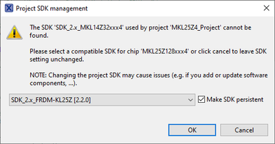

 When I debug my firmware on MCU of  MKL25Z128 using PnE. It always failed and hang MCUXpress IDE software. IDE found PnE device and PnE works well under Code Warrior.  Is there anything wrong with my settings? Many thanks.

I managed to make the debugger works now. Thanks for your help.

  Here is my project. Many Thanks to your kind help.

I noticed that in your project you have the wrong SDK/MCU assigned?
This can cause all kind of problems, so I suggest that you change the SDK to the KL25Z one.
