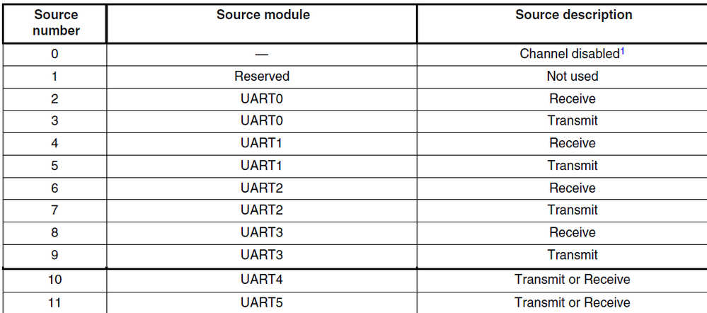

the DMA request sources
In terms of UART0~UART3,UART Transmit and UART Receive are DMA sources respectively.But UART4~5 only have one source which is UART Transmit or Receive.
Does it mean UART4/5 can't transmit and receive both in DMA mode?Or I have to make sure the process of transmit and receive is at different time.
What should I pay attention to in the program?

Thanks for your reply.The device is MK64FN1M0VMD12.

You can use DMA on either TX or RX but not both, in K64 both UARTs 4 and 5 have this restriction.
If you connect the source to a DMA channel with both RX and TX DMA triggers enabled either of them will trigger a DMA transfer, which means that RX will disturb TX and TX will disturb RX.
I think that you will need to decide on the direction to use DMA mode and use interrupt on the other.
UARTs: http://www.utasker.com/docs/uTasker/uTaskerUART.PDF
I hope this information help you!.
