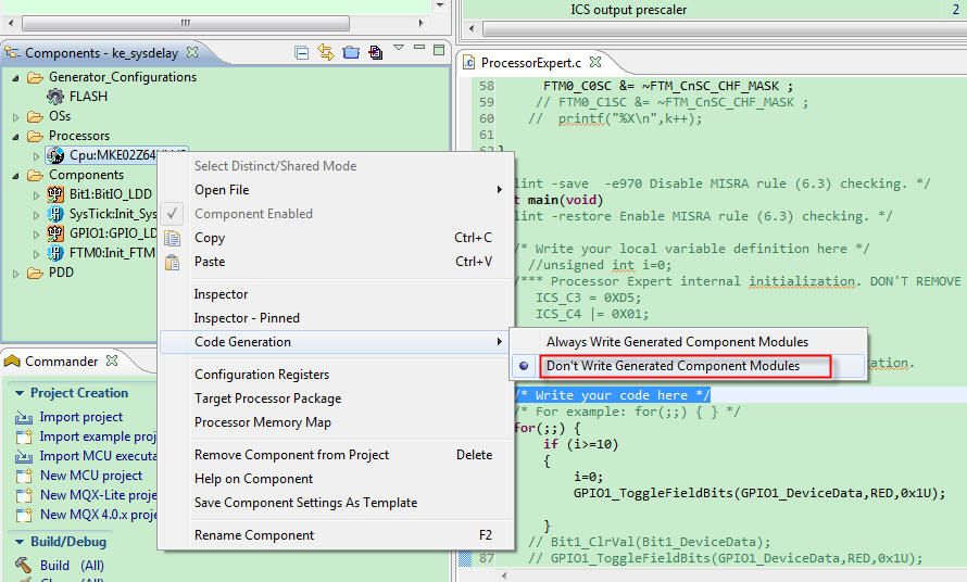

    But if you don't want the CPU.c or component.c not be changed, please do like the following:
Just choose "Don't write generated component modules", the the according code will be lock when you generate the new PE code.
I hope my answer will help you!
