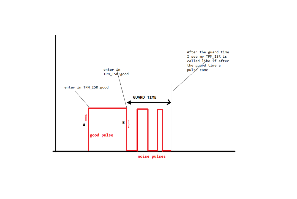

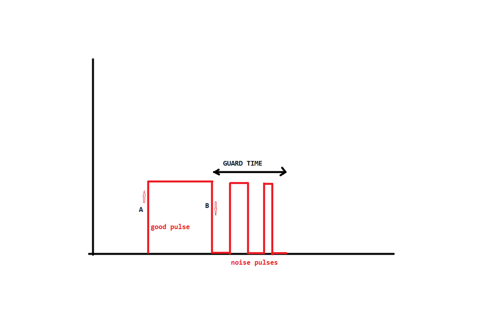

Hi, I need to measure a pulse (see the image) so I config a TPM in capture mode, at the begin rising edge interrupt is active, when I enter in the ISR, falling edge interrupt is actived. When a falling edge comes I stay in the ISR for a certain delay (guard time) so I avoid to capture noise. But as soon as I exit from ISR a while after the ISR is called again. It is like there was a pending bit,but that's impossible because before to exit I reset the pending bit (TPM0_C0SC |= (0x80);). It doesn't happen if I disable the interrupt by TPM0_C0SC |= (0x40); but in theory it shouldn't be necessary and anyway interrupt flag keep on working.
What happening? Any idea?

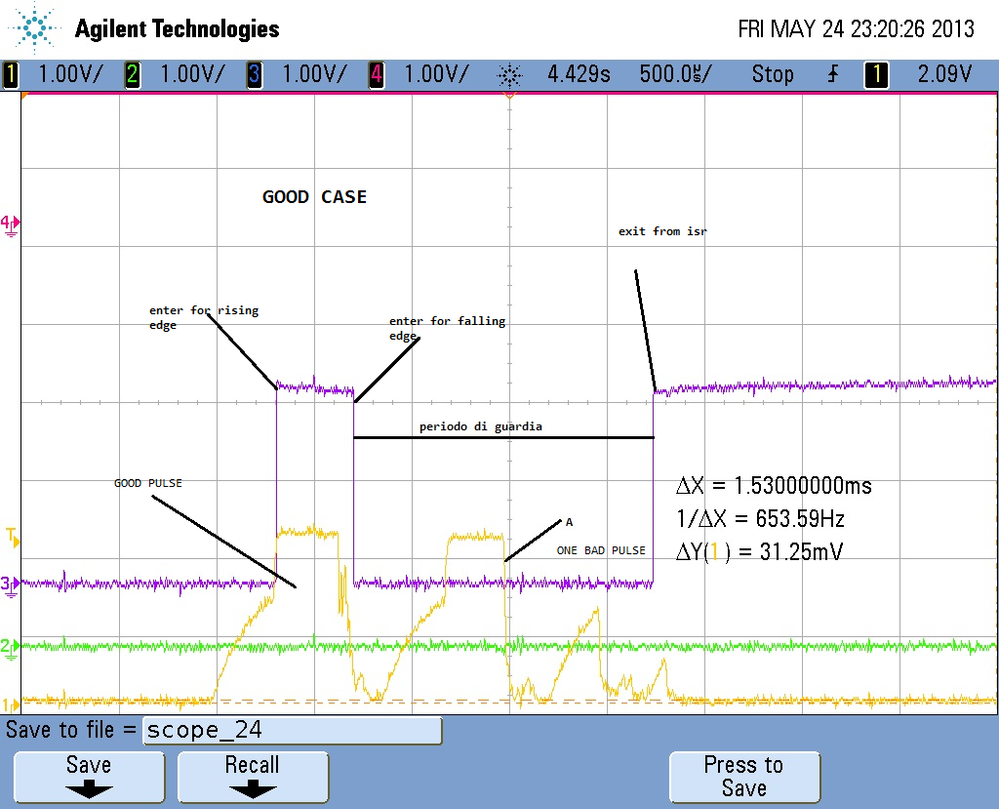

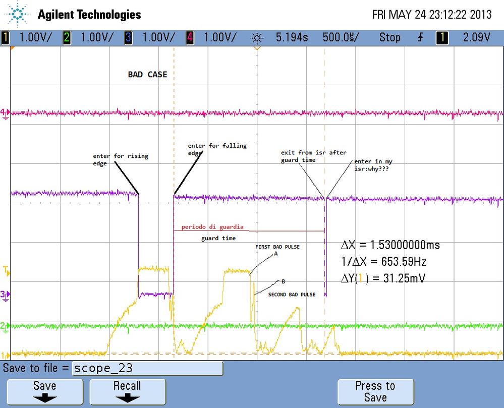

Hi again, I send you the true cases images.
6,000 Views
jeremyzhou
Hi Stefano,
I've had a careful look through your reply. Regard to the two screenshots, I'm also surprize about that and it seems like the flag can't been clean when two bad pulse happen.

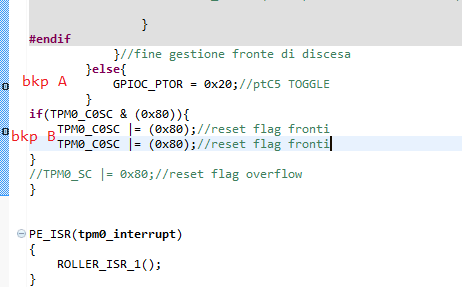

Hi Ping, I send you two projects for frdm-kl25z (how send .rar??), the first generate 2 pulse on ptb2 pressing a button on ptb0, the second config ptc1 as input capture. Put breakpoints like in the picture. You are going to see the first stop on bkp B then on bkp A but in th is case you wont see any pending interrupt. Very very strange.

What I see from osciloscope is that when I enter in my ISR because of a falling/rising edge after a while I exit from ISR, again the ISR is called but this time not for a rising/falling edge like there were another interrupt source but  TMP0_C0SC_CHF=0 and TMP0_SC_TOIE=0 (overflow interrupt disabled). Try yourself: generate a rising edge, then if( (TPM0_C0SC & 0X80)){toggle a pin}else{toggle another pin);you will see you will enter in the ISR twice.

As you can see, after the guard time I reset the possible pending (rising/falling)interrupt but as soon as I exit from ISR, the ISR is called again like there were a pending interrupt.
That happens only if the situation is like that showed in the image: two unwanted pulse; but if there is only one unwanted pulse all goes well. It is like in the guard time the pending interrupts were queued and TPM0_C0SC |= (0x80); only deletes one.
Only work if i disable interrupt by TPM0_C0SC &= (~0x40); before the guard time and then I re-enable it when guard time elapsed.
