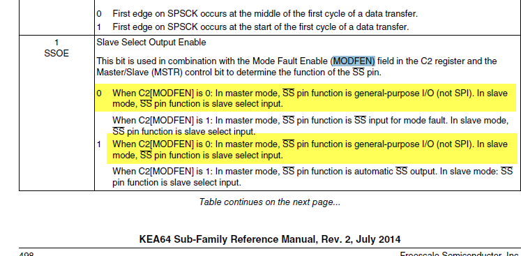

Is it possible to work with 24-bit words via the SPI port on the KEA64? I am able to read 24-bits no problem, but when I send, there is always a clock cycle break between bytes.

Hi Robert,
  It's easy to realize it, just don't use the hardware SPI SSEL function.
  Use the GPIO function instead of the hardware SPI ssel function.
  You can configure C2[MODFEN] as 0:
Or you also can use the other GPIO pin as the SSEL pin.
 Before your send the SPI data, pull the SSEL low at first, after the SPI data send finished, then pull the SSEL high.

   Do you use both the KEA as SPI master and slave?
   In the Slave side, please enable the SSEL function, don't do it like master.
