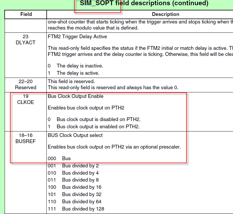

you can test your bus clock to make sure whether your clock is correct,  from our reference manual, PTH2 is the bus out pin. You can use this pin to test.
Enable the bus out pin ,just add this code :
SIM->SOPT |=(1<<19);
SIM->SOPT &=0xf8ffff;
If you don't change the EXT_CLK_FREQ_KHZ to 20000, please change it, and test your eeprom again!

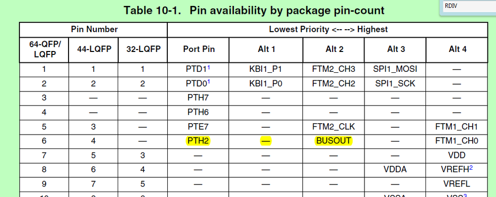

I'm using the 32 pin device, so I don't have the option of routing
the bus clock to an external pin.

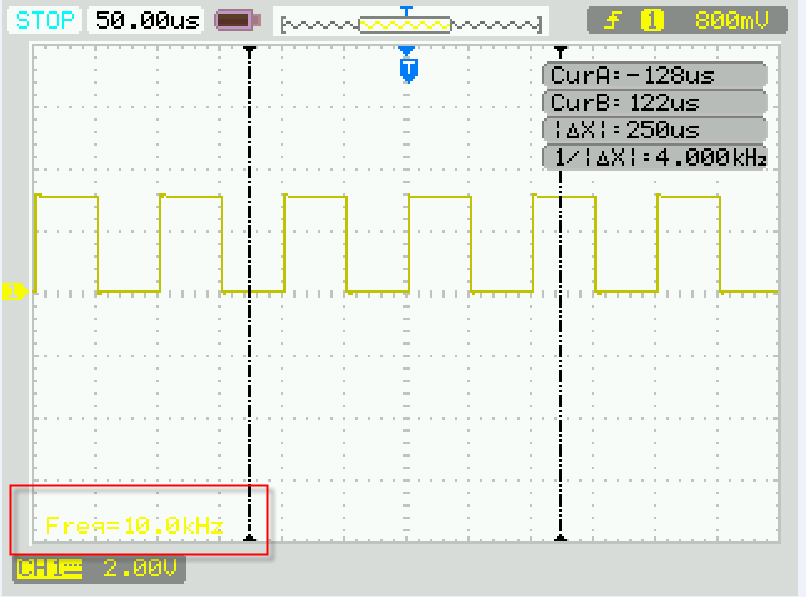

       Now, we need to check your real bus clock, if you don't have the busout pin, you can use RTCO pin to check your bus clock, just need to add some RTC code, and test a pin wave.
Th is use RTC to test your busclock,  if your busclock is 20Mhz, your PTC5 pin will have a 10Khz wave, just like follows:
So, could you please add the code, and test the PTC5 pin's wave, and give it to me?

Setting the RTC to use the bus clock with a modulo of 9 gives me
exactly 10KHz on PTC5. So that confirms that my bus clock is 20
MHz. We've confirmed before that the flash configuration for a 20

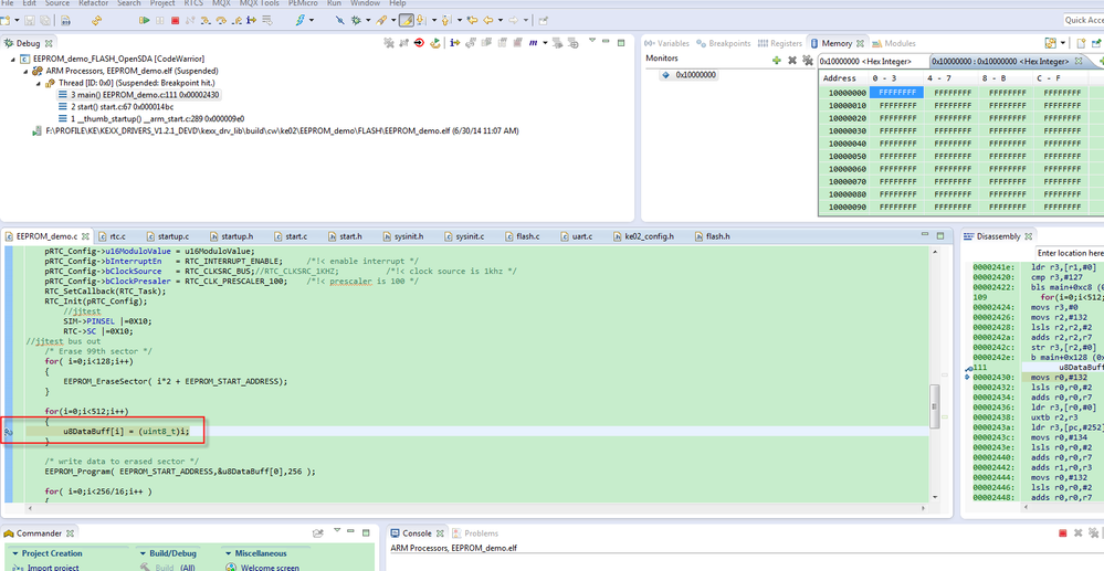

What happens is I tell the debugger to run by clicking on the run
button (the green right arrow picture you show in your
response). The debugger runs for a short time then exits. I don't
have the popup anymore, but the debug and console windows are shown
in the attached picture.

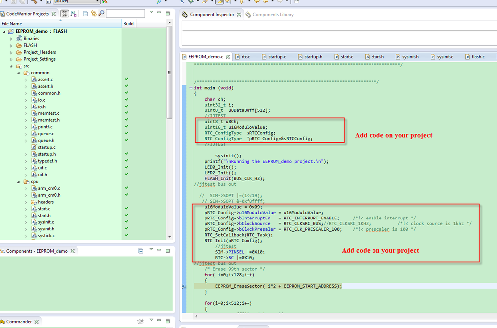

The second picture shows my test code. If I set a breakpoint at line
20 (with the for loop delay commented out), then keep running to the
breakpoint, the long delay for each breakpoint is long enough to make
it work. If I run without the breakpoint (again with the for loop
commented out), I get the session terminated problem. If I put the
for loop delay in by uncommenting it, then everything works fine
again with the long delay. This is why I believe there is a timing
issue somewhere with the EEPROM.

     If you also have the 10Khz on the PTC5, your bus clock is really 20Mhz, that is correct, about the RTC working question, after this problem is solved, I will discuss with you about it , your RTC is correct.
    From your picture, I find it is not our KE02 driver project, so could you give me your project, I will help you to check it, I need to make sure whether it caused by your software. I will use your project, and change my oscillator to 20Mhz, then test it to see whether the project works OK or not.
     Waiting for your project.
Jingjing
