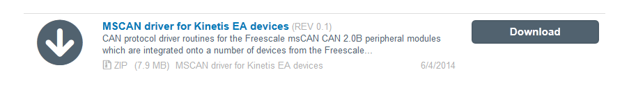

Hello Vignesh,
- There is MSCAN driver for kea-128 chip :
Kinetis KEA128 StarterTRAK CAN Applications|Freescale
And if you use the KDS IDE, you can create PE project , then there are all of the basic driver about KEA-128 .
Hope it helps
Alice
