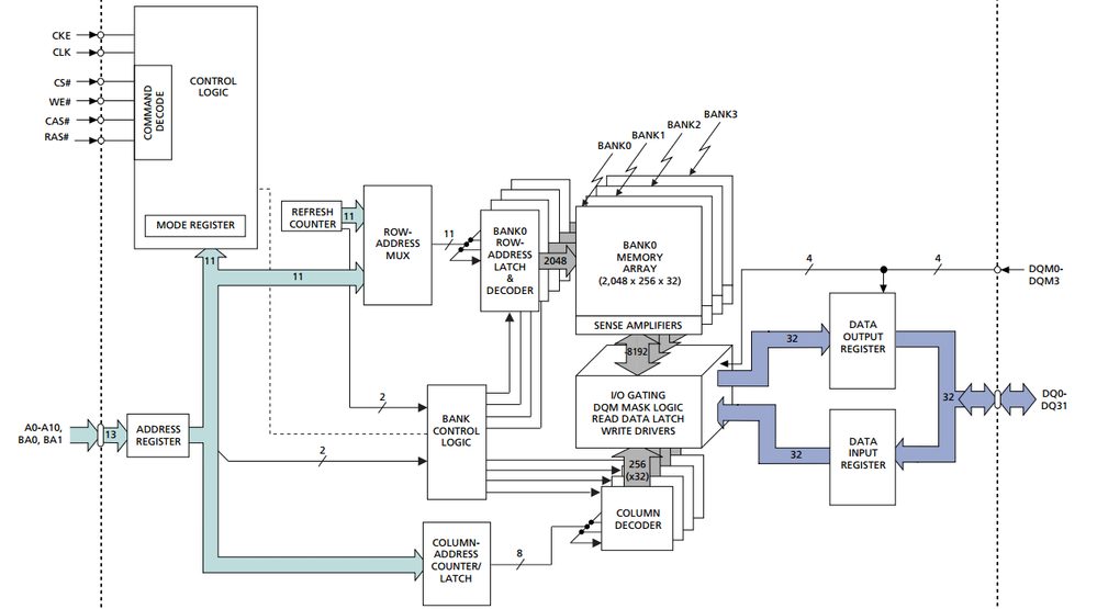

Is the documentation for X-TWR-K65F180M correct. SDRAM_A16 is skipped?

I think my question is answered with the APP NOTE AN5095

TWR-K65F180M board is using MT48LC2M32B2P-5 SDRAM, which block diagram could be found below:
Customer could find TWR-K65F180M board schematics from here.
Wish it helps.
