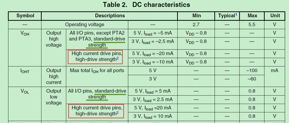

    what is the current coming out of a GPIO in KEA-128?

Some GPIO pins of KEA128 have high current drive capability, more detailed info please check KEA128 reference manual chapter 11.7.6.
Please check below datasheet table about GPIO two type drive strength pins data:
Wish it helps.
