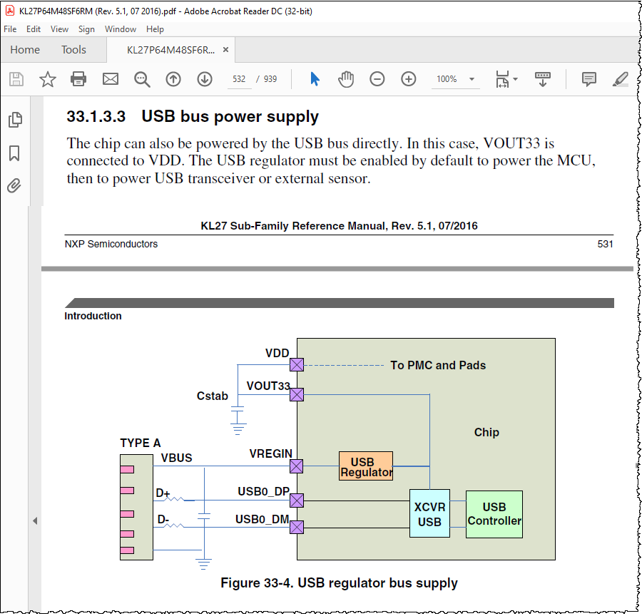

Robin_Shen
Hi Raduan,
Please show us the schematic of your custom board. Does the circuit of your custom board same as FRDM-KL27Z or the "33.1.3.3 USB bus power supply"?
If your custom board same as FRDM-KL27Z, then you just need to switch from semihosting to UART, please refer: MCUXpresso IDE and Semihosting.
If you don't want to output the data through UART(using externa UART-2-USB adapter), only want to data output through USB0_DP and USB0_DM then you may need to migrate the I2C example to USBCDC example.
