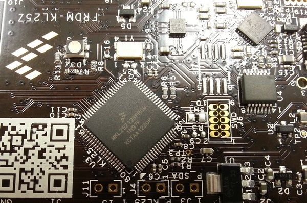

Dear Sir,
   I have two freedom boards. The chip number one is MKL25Z128VLK4_0N97F, and the other is MKL25Z128FRDM_1N97F.
I am not sure what the difference is between with them. Because I tried the hid_keyboard example in Freescale USB Stack v4.0.3,
using MKL25Z128VLK4_0N97F, the HID keyboard device could show in my PC, but using MKL25Z128FRDM_1N97F could not.
I found it always in the loop
    while((MCG_S & MCG_S_IREFST_MASK) != 0x00U) { /* Check that the source of the FLL reference clock is the external reference clock. */
It seems to mean that MKL25Z128FRDM_1N97F doesn't select external reference clock.
IREFST bit in MCG Status Register (MCG_S) is not 0, and CLKST bits is not 10.
But MKL25Z128VLK4_0N97F is normal.
Could you please help me to resolve this issue?

Your issue is because in one of your boards R25 is populated, and in the other no.
You can find the solution here:
http://mcuoneclipse.com/2012/10/27/using-the-8-mhz-crystal-on-the-frdm-kl25z-freedom-board/
