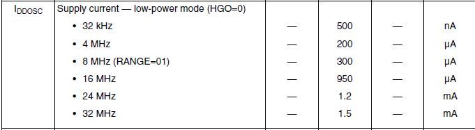

What is the difference between MK11DN512AVLK5 & MK11DN512VLK5 ?

DerekLau
MK11DN512AVLK5
MK11DN512VLK5

eduardrazumovsk
Thanks for the answer
Is this the only difference ?
Regardless the supply current, i can use each ? they are pin compatible ?

PatriciaTeran
Hi, Eduard
There are a few differences, but in general they are pretty much the same, and yes they are pin compatible.
You can download a document at this link so you can review all the differences.
http://cache.freescale.com/files/microcontrollers/doc/eng_bulletin/EB800.pdf?fasp=1&WT_TYPE=Engineer...
Hope it helps.
Best regards!
