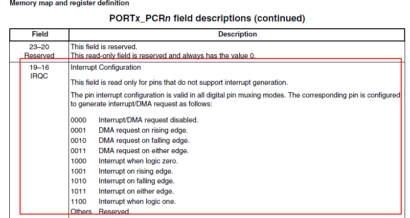

You also need configure  the interrupt of the pin use the "PORTx_PCRn" register.
Also configure the pin to GPIO function, enable the related interrupt.
For example : set PTA19 for GPIO interrupt when the pin is logic zero
SIM_SCGC5 = SIM_SCGC5_PORTA_MASK;
  PORTA_PCR19=PORT_PCR_MUX(1)|PORT_PCR_IRQC(0x08)|PORT_PCR_PE_MASK|PORT_PCR_PS_MASK;
enable_irq(87); //GPIOA Vector is 103. IRQ# is 103-16=87

then when you set the pta10 to zero , it will enter interrupt function.
