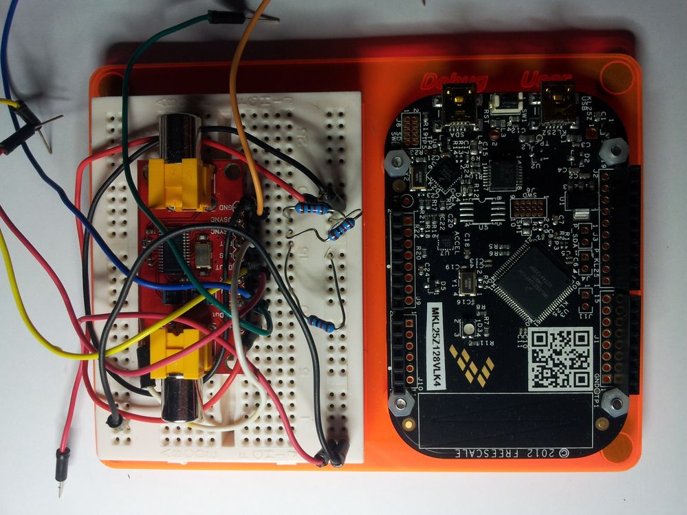

20130527_221511.jpgHi Eli, I made a prototyping  board using acrylic and I used a set of calipers to do the same as I was in a hurry.
